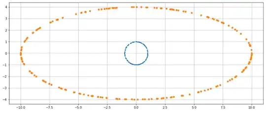

Update : The results with Cholesky factor decomposition.
dim = 2 # test in 2D
r=1
A = np.array([[1/10**2, 0],
               [0, 1/4**2]])
L = np.linalg.cholesky(A).T
x = np.random.normal(0,1,(200,dim))
z = np.linalg.norm(x, axis=1) dimension z = z.reshape(-1,1).repeat(x.shape[1], axis=1) y = x/z * r #uniform points on a sphere y_new = np.linalg.inv(L) @ y.T # expected transformation
plt.figure(figsize=(5,5)) plt.plot(y[:,0],y[:,1], linestyle="", marker='o', markersize=2) plt.plot(y_new.T[:,0],y_new.T[:,1], linestyle="", marker='o', markersize=5) plt.gca().set_aspect(1) plt.grid()

    @Artashes Since no one answered the question yet, there is no need to append UPDATE sections. Feel free to refine the whole question and if comments are orphaned, so be it. Also, please post code in ASCII form using the {} instead of taking a screenshot of the code snippet. If someone would like to replicate your experiment, why should that someone write the whole code snippet again? – Rodrigo de Azevedo Nov 16 '22 at 14:19

  • @Artashes Why are you expecting an uniform distribution of the coordinates? – Stéphane Laurent Dec 10 '22 at 03:43
    @Artashes Even for the circle the coordinates have a U-shaped distribution. – Stéphane Laurent Dec 10 '22 at 03:45
    @Artashes Consider two elliptical arcs whose projections on the x-axis are two segments of same length. Which arc is the longest one? Conclusion? – Stéphane Laurent Dec 10 '22 at 04:53
  • Oh Sorry, my bad, your completly right ! Merci beacoup @StéphaneLaurent – Artashes Dec 10 '22 at 14:46
  • @Artashes Actually I have a doubt. I sampled 1000000 points on an ellipse and I computed the proportion of these points which lie in a certain elliptical arc. I compared this proportion with the ratio of the arc length divided by the ellipse perimeter, and they are slightly different. If the sampling is uniform then the proportion and the ratio should be equal. If I take for the elliptical arc the quarter from $(a,0)$ to $(0,b)$ then I find $1/4$ as expected. – Stéphane Laurent Dec 10 '22 at 14:52
  • Wil you still obtain the same number of points if you take 2 arcs (of the same length ~1/12 of the perimeter) one on perigee and another on apogee ? – Artashes Dec 10 '22 at 15:00
  • @Artashes I was right, this method is wrong. See my edit. – Stéphane Laurent May 19 '23 at 18:29
