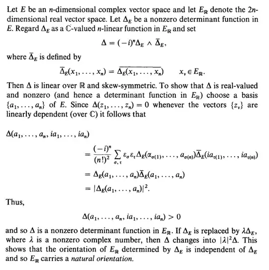

Consider the following argument from a book (included as an image to show exactly what is printed): Natural orientation of underlying real space
There are a number of minor typos here, but I'm mainly concerned with the computation of $\Delta(a_1,\ldots,a_n,ia_1,\ldots,ia_n)$. In the definition of $\Delta$ I'm assuming that the author is using the Grassmann product defined earlier in the book, which here would give $$\Delta(x_1,\ldots,x_{n+n})=\frac{(-i)^n}{(n!)^2}\sum_{\sigma\in S_{n+n}}\varepsilon_{\sigma}\Delta_E(x_{\sigma(1)},\ldots,x_{\sigma(n)})\overline{\Delta}_E(x_{\sigma(n+1)},\ldots,x_{\sigma(n+n)})\tag{1}$$ If I take $E=\mathbb{C}$ (so $n=1$), then from (1) I obtain $$\Delta(a_1,ia_1)=-2|\Delta_E(a_1)|^2<0$$ Even using the expression on the right-hand side of the first equality in the computation from the book, I obtain $$\Delta(a_1,ia_1)=-|\Delta_E(a_1)|^2<0$$ If I am correct, does someone know what the definition of $\Delta$ should be to yield the desired result (for all $n$)?

    Just a philosophical remark: This should be viewed as a generalization of $dz\wedge d\bar z = -2i,dx\wedge dy$ in $\Bbb C$. Thus, $dx\wedge dy = \frac i2 dz\wedge d\bar z$. This suggests that the author's sign is indeed wrong and that your factor of $2$ may also be correct. – Ted Shifrin Nov 04 '22 at 21:26

I think that $\Delta = (-i)^n\Delta_E\wedge\bar\Delta_E$ is a typo and should be $$ \Delta = {\color{red}{\frac1{(-i)^n}}}\Delta_E\wedge\bar\Delta_E = i^n\Delta_E\wedge\bar\Delta_E. $$ This is somewhat natural since (as Greub is trying to convince us) $$ \Delta_E(ia_1, \dotsc, ia_n)\wedge\bar\Delta_E(ia_1, \dotsc, ia_n) = i^n\Delta_E(a_1,\dotsc,a_n)\wedge\bar\Delta_E(ia_1,\dotsc,ia_n) $$ is non-zero and real. It could also be the case that Greub meant to write $$ \Delta(ia_1, ia_2, \dotsc, ia_n, a_1, a_2, \dotsc, a_n) $$ in which the case the definition of $\Delta$ as written by Greub is the one required.
In either case, the argument proceeds by suggesting to the reader that $\sum_{S_{2n}} = \sum_{S_n\times S_n}$ when evaluating this particular wedge product. This doesn't seem outlandish to me, but I also don't immediately see how that works.
What I will do is give a more abstract approach, which completely avoids the tedious combinatorics. It would be a good exercise to pinpoint how this argument lines up with Greub's.

In light of part of Nicholas' answer, and Ted's comment, I think Greub should have defined $\Delta$ by $$\Delta=\frac{i^n}{2^n}\Delta_E\wedge\overline{\Delta}_E$$ Then equation (1) in my question becomes $$\Delta(x_1,\ldots,x_{n+n})=\frac{i^n}{2^n(n!)^2}\sum_{\rho\in S_{n+n}}\varepsilon_{\rho}\Delta_E(x_{\rho(1)},\ldots,x_{\rho(n)})\overline{\Delta}_E(x_{\rho(n+1)},\ldots,x_{\rho(n+n)})\tag{1'}$$ Taking $x_k=a_k$ and $x_{n+k}=ia_k$ for $1\le k\le n$, what are the non-zero terms in the sum on the right side of (1')? First observe that in such a term the subscripts associated with the $a$'s and $ia$'s (not the $x$'s) occurring within $\Delta_E$ must be distinct, lest there be a linear dependence relation over $\mathbb{C}$ which causes $\Delta_E$, and hence the term, to be zero. Similarly for $\overline{\Delta}_E$. If the subscripts within each of $\Delta_E$ and $\overline{\Delta}_E$ are strictly increasing (call this an increasing term), then the term is nonzero and for each $1\le k\le n$ we must have either $$\rho(k)=k\quad\text{and}\quad\rho(n+k)=n+k\tag{2}$$ or $$\rho(k)=n+k\quad\text{and}\quad\rho(n+k)=k\tag{3}$$ Note there are $2^n$ such permutations $\rho$, and $\varepsilon_{\rho}=(-1)^p$ where $p$ is the number of $k$ for which (3) holds, which is just the number of $i$'s appearing within $\Delta_E$. These $i$'s can be moved over to $\overline{\Delta}_E$ by multiplying by $(-1)^p=\varepsilon_{\rho}$, since $\Delta_E$ is $\mathbb{C}$-multilinear and $\overline{\Delta}_E$ is conjugate $\mathbb{C}$-multilinear. Now every non-zero term is obtained from a unique increasing term by applying unique signed permutations $\sigma,\tau\in S_n$ to $\Delta_E$ and $\overline{\Delta}_E$, respectively. So we obtain $$\begin{align*} \Delta(a_1,\ldots,a_n,ia_1,\ldots,ia_n)&=\frac{i^n}{2^n(n!)^2}\cdot2^n\cdot\sum_{\sigma,\tau\in S_n}\varepsilon_{\sigma}\varepsilon_{\tau}\Delta_E(a_{\sigma(1)},\ldots,a_{\sigma(n)})\overline{\Delta}_E(ia_{\tau(1)},\ldots,ia_{\tau(n)})\\ &=\frac{i^n}{(n!)^2}\cdot(n!)^2\cdot\Delta_E(a_1,\ldots,a_n)\overline{\Delta}_E(ia_1,\ldots,ia_n)\\ &=\Delta_E(a_1,\ldots,a_n)\overline{\Delta}_E(a_1,\ldots,a_n)\\ &=|\Delta_E(a_1,\ldots,a_n)|^2>0 \end{align*}$$ A bit tedious, not as slick as an abstract argument, but it seems to work.

    This looks good. The hard part for me was Eqs. (3) and (4), but I've convinced myself that that makes sense. You could say the abstract argument "cheats" because the fact that $$\sum_{S_{2n}} = \sum_{S_n\times S_n}$$ here is exactly the fact that $${\bigwedge}^{2n}E_{\mathbb R} = {\bigwedge}^n\mathrm{Re}(E) \mathbin{\hat\otimes}{\bigwedge}^ni\mathrm{Re}(E),$$ which I conveniently don't provide a proof for :) – Nicholas Todoroff Nov 06 '22 at 21:40
