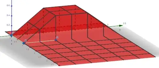

I would like to show a graphical proof.
The sum $E$ (initial of Endpoint) of 2 uniform random variables $A \sim U_{[0,1]}$ and $S \sim U_{[0,2]}$ is known to be this trapezoidal-shape function:
$$g(x)=\begin{cases} \ \ \ \frac12x&(0\le x\le 1)\\ \ \ \ \frac12&(1\le x\le 2)\\ -\frac12x+\frac32&(2\le x\le 3) \end{cases}\tag{1}$$
This is for interval $[A,\underbrace{A+S}_E]$. Same distribution for interval $[B,\underbrace{B+T}_F]$. Let us consider the complementary event : "the bulbs are not lit at the same time". It is clear, by symmetry, that the probability of this event is twice the probability of having $E<B$.
By (assumed) independence, the joint pdf if the product of the individual pdfs:
$$h(x,y):=f(x)g(y)\tag{2}$$
(where $f$ is the pdf of $U_{[0,1]}$ and $g$ defined by (1)).
$P(E<A)$ is equal to the volume $\frac{1}{12}$ under the surface with equation (2) and above the triangular area $PQR$ (for which $y<x$) shown in the figure below (i.e., the volume of a pyramid with basis area $\frac12$ and height $\frac12$). Doubling this volume gives the final result for the complementary event: $\frac{1}{6}$.
