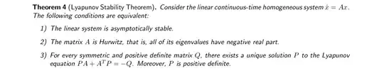

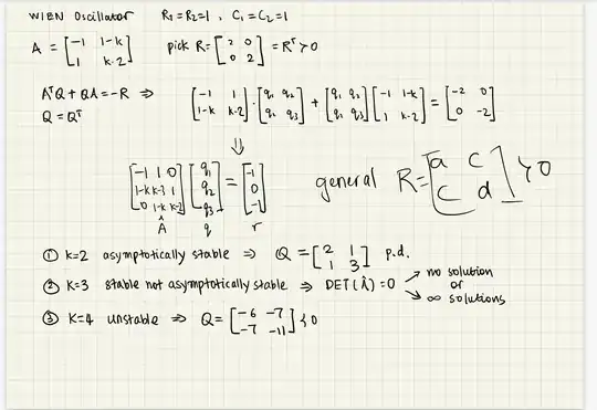

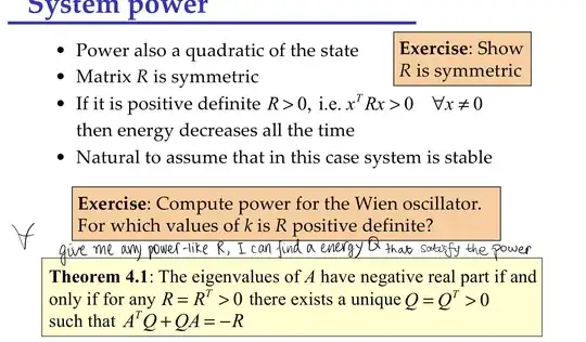

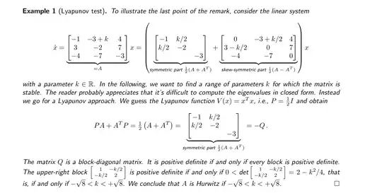

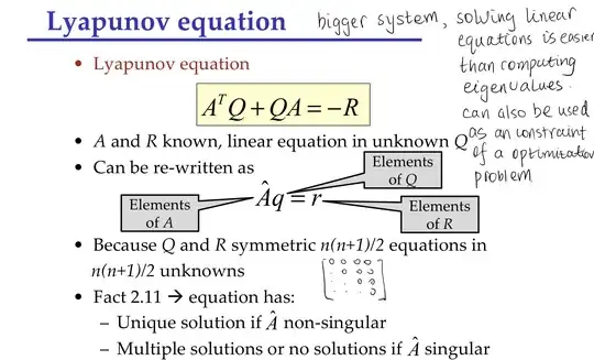

For reference, I have taken two classes that stated this theorem with an example. Here are the screenshots. The first two images are from the first lecture with an example of "given a $P$, find a $Q$ and the system is asymptotically stable". The next three images are from the second lecture, saying the same theorem, with an example of "given a $Q$, find a $P$ and the the system is asymptotically stable".
Appreciatively, William
Lecture 1 theorem: Lecture 1-1 Lecture 1 example: Lecture 1-2
Lecture 2 theorem: Lecture 2-1 Lecture 2-2 Lecture 2 example: Lecture 2-3

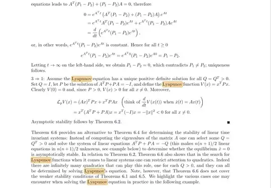

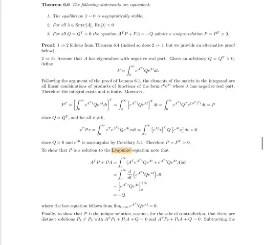

I found a proof from the same prof's higher level class proving that these three statements are equivalent, which further confuses me why it's sufficient to have one satisfying example and conclude the asymptotical stability.
proof-1 proof-2

I suspect that your professor might have combined the single case (one positive definite $Q$) together with the theorem of the Lyapunov equation.
Namely, the equation $P\,A+A^\top P=-Q$ arises from the Lyapunov function $V(x)=x^\top P\,x$ combined with the dynamics $\dot{x}=A\,x$. Using the dynamics in the Lyapunov function when evaluating it time derivative yields
\begin{align} \dot{V}(x) =& x^\top P\,\dot{x} + \dot{x}^\top P\,x, \\ =& x^\top P\,A\,x + x^\top A^\top P\,x, \\ =& x^\top (P\,A + A^\top P)\,x. \end{align}
So if $P\,A+A^\top P=-Q$ then $\dot{V}(x) = -x^\top Q\,x$. So if you can find a single pair of positive definite $Q$ and $P$ that satisfy this, then you have a radially unbound positive definite Lyapunov function for equilibrium $x=0$ of $\dot{x}=A\,x$ which has a negative definite time derivative. This is sufficient to show global asymptotic stability.
The theorem of the Lyapunov equation states that if $\dot{x}=A\,x$ is globally asymptotically stable, then for every positive definite $Q$ there is a positive definite $P$ such that $P\,A+A^\top P=-Q$. However, the previous paragraph showed that if a single pair of positive definite $Q$ and $P$ that satisfies $P\,A+A^\top P=-Q$ the system can be shown to be globally asymptotically stable. Thus from the theorem of the Lyapunov equation it follows that if one can find a single pair it implies that for every positive definite $Q$ there exists a positive definite $P$ that also solves $P\,A+A^\top P=-Q$.
I think there is just a typo in your Lecture 1. There the theorem says "for every $Q$..." but the statement in Lecture 2 says "for any $R$..." (I have no idea why the notation was switched here), which seems more consistent with the statement on Wikipedia.

  • I thought both "for every" and "for any" are "$\forall$", aren't they? Did I misunderstand? – William Lin Oct 11 '22 at 17:37
  • @WilliamLin: hmm. I think it's ambiguous. "$\exists$" seems to be what your examples imply (finding only one $Q$), also seems to be what seaver is implying in the comments, and seems more consistent with the statement on Wikipedia. You can find a discussion of the ambiguity of "for any" here: https://math.stackexchange.com/questions/430646/difference-between-for-any-and-for-all – Qiaochu Yuan Oct 11 '22 at 17:45
  • At this point I think you should just ask your professor what the correct statement is. – Qiaochu Yuan Oct 11 '22 at 17:45
  • I indeed found proof of the same prof's higher level class that it's "$\forall$". I attached it to my question. It confuses me then why finding one example is sufficient to conclude its asymptotic stability... – William Lin Oct 11 '22 at 17:59
