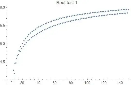

To be more specific on the problem of having access to only the numeric values of $c_n$, I'll show my attempts with the root and ratio tests. I compute the first 150 $c_n$ coefficients and plot $\vert c_n\vert^{1/n}$ as a function of $n$:
Root test 1

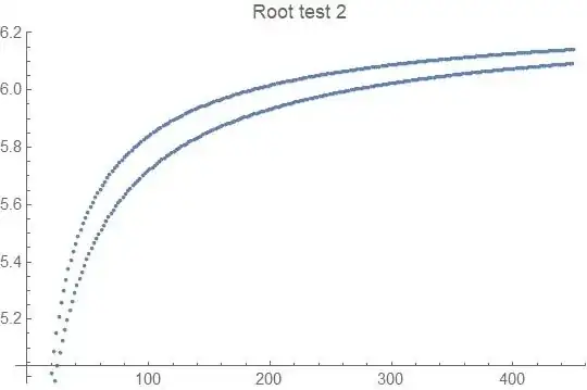

To me this picture does not make it clear whether or not the sequence approaches a finite value. With a little effort, I compute more coefficients, this time I go to 450. This is the result
Root test 2
Which looks as inconclusive as the previous picture, as I cannot tell if the sequence approaches a value at around $2\pi$ or grows to infinity.

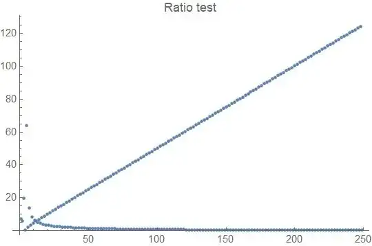

Interestingly, the ratio test looks like this:
Ratio test
Where the sequence that I plotted is $\vert c_{n+1}/c_n\vert$. It seems that the "sub-sequence" given by odd n+1 and even n goes to zero while that given by even n+1 and odd n goes to infinity. I am unsure if the presence of the seemingly divergent contribution is a reason strong enough to claim the power series has zero radius of convergence.

    No amount of approximation will tell you information about a limit, unless you know additional information about what you are computing. If there is an original problem motivating this question, post that problem instead. Your modeling of it into this new question, makes it have the answer "nothing can be said". – plop Sep 30 '22 at 10:22
    Good question, but @user85667 has the correct answer here. Unfortunately without proper analytical bounds, we cannot say anything definitive about a sum when we can only access a finite number of its terms – Zim Sep 30 '22 at 10:32
    From the first plots it is quite logical to separate the odd and even index coefficients for the ratio test. Then the asymptotic behavior of the ratios $\frac{|c_{n+2}|}{|c_n|}$ should show a similar behavior to the root test (with a squared size, as 2 steps are combined). – Lutz Lehmann Sep 30 '22 at 11:49
  • @LutzLehmann that is absolutely true, thanks for the insight. If I understand correctly, this renders the ratio test as inconclusive as the root test (in the sense it cannot be clearly seen whether the sequence grows to infinite). – Néstor González Gracia Sep 30 '22 at 13:12
    Yes, that remains the case. What you can do with such finite information is to build a model for asymptotic convergence, estimate its parameters, and then try to prove it via the sequence construction process. But for the overall question the answer appears quite clear, there is no convergence to zero visible in the graphs, so most likely the radius of convergence is finite. But obviously some slow divergence like in $\ln(\ln(n))$ and thus radius zero can not be excluded. – Lutz Lehmann Sep 30 '22 at 13:22
  • Run the ratio test on odd terms alone. – Ivan Neretin Sep 30 '22 at 13:33
