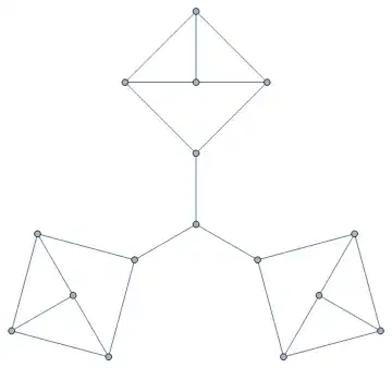

Start with the standard $16$-vertex example of a $3$-regular graph with no perfect matching:
Why doesn't it have a perfect matching? Because each $5$-vertex petal does not have a perfect matching on its own, and the center vertex can only help one of the three petals.

When we do this, one of the three petals of $G$ is connected to $H$, so we have no control over what kind of matchings exist there. However, the other two petals still have the old problem: each one of them has no perfect matching on its own, and the central vertex of $G$ can only help one of the petals.
Since this infinite $3$-regular graph has no perfect matching, it cannot be $3$-edge-colorable: any color class in a $3$-edge-coloring of a $3$-regular graph has to be a perfect matching. So there you are: class two.
