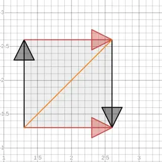

Here is a obvious triangulation into two triangles:
Gluing diagram for Klein Bottle
Glue the red arrows together, and the black arrows together to get a Klein Bottle from the gray square.
The other way round, we can cut at the arrows and also cut at the yellow line to get 2 triangles from a Klein Bottle.
However, you could also glue a single triangle to a Klein Bottle, if the condition is dropped that complete edges shall be glued to complete edges.
FYI, I make the plot here (Desmos)
