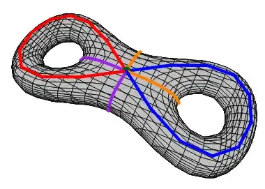

What are some surfaces of constant integral curvature of genus $g>1?$ What are the simplest 3d forms/parameterizations?
From the Gauss-Bonnet theorem classical definition has it
$$ \Omega=\int_U K dA= 4\pi(1-g)$$
For the sphere, single and double holed tori $ (g=0,1,2)$ we have $(\Omega =4 \pi,0, -4 \pi) $ respectively.
EDIT 1:
For example I want to see an image and its parameterization of a surface with $\Omega= -5, g\approx 1.398 ; \;$ Is that possible?
To me it makes sense to regard $\Omega $ as a geometric scalar, an isometric invariant. For example take any patch of a "circle" of constant "radial"distance from a single center C on a surface of constant arbitrary positive or negative $K$ swept by geodesic polar coordinate of arbitrarily constant radial length $u$ . This spherical/pseudospherical segmented patch has a constant $\Omega.$ This is a special, may be trivial case of constant integral curvature.
Afik KF Gauss did not define Integra Curvatura $\dfrac{\Omega}{4 \pi}$ to be valid only for integers $\mathbb Z$ in the context of Gauss-Bonnet theorem or elsewhere.
Seen that way however it also appears impossible because by definition the genus turns out fractional or non-integer. Genus is an integer, fractional holes like $ g\approx 1.398$ number of holes to me sound meaningless.
Just as fractional factorial and fractional differentiation were validated by latter day definitions, has a topological or integral calculus meaning been arrived at for a surface with e.g.,$\;g=$ three and a quarter number of holes?
Thanks!
