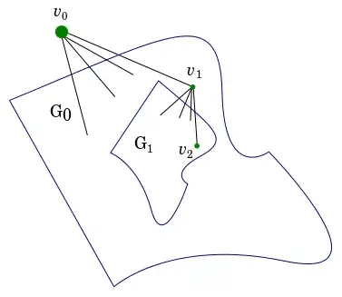

Hint for #1: Suppose that $G_0$ is the purported graph, which contains any graph $H$ unless $H$ in turn contains $K_\omega$, the complete countable graph. Make a new graph, $G'_0$, by appending a new vertex $v_0$ to $G_0$ and adding edges from $v_0$ to every vertex of $G_0$. Then $G'_0$ does not contain $K_\omega$ (you prove this), so by hypothesis there must be a copy of $G'_0$ strictly inside of $G_0$, which we can call $G'_1$, and $G'_1$ must have an analogous vertex $v_1\ne v_0$.
diagram of graph

  • This vertex $v_1$ has to be connected to every vertex of the copy $G_1'$. How does this lead to a contradiction? Maybe I should continue this process to construct a countable sequence of $v_n's$ that are all connected with one another? How will that work, if we don't even know that $v_0$ and $v_1$ are necessarily connected? – ctlaltdefeat Jul 22 '13 at 17:56
  • Are you sure you don't know that $v_0$ and $v_1$ are connected? Think about it a little more. – MJD Jul 22 '13 at 17:57
  • Ah silly me of course $v_1$ is connected to $v_0$. Then in the next step, we let $G_1$ = $G_1'$ without $v_1$ and its edges (is that the correct definition?). Now $G_1$ is isomorphic to $G_0$ (right?), and that way we continue. Please correct me if I made a mistake. – ctlaltdefeat Jul 22 '13 at 18:11
    @ctlaltdefeat: Your reasoning is fine, and ${v_k:k\ge 1}$ ... – Brian M. Scott Jul 23 '13 at 00:25
