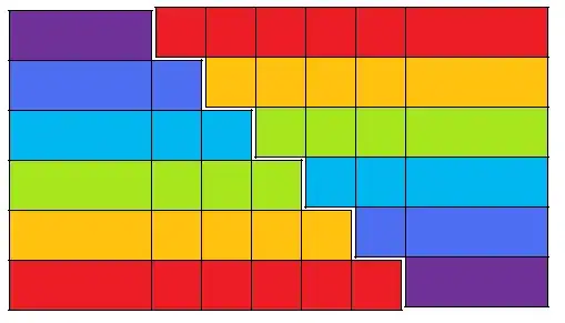

I find this chart sufficient to make the point

Row-first sum $ = 2\:\! s_n.\ $ Column-first sum $ = n\ (a_1+a_n)\ $ since each column sum is constant (by hypothesis $\ a_{i+1}-a_i\: =\: a_j - a_{j-1}\:$ so $\ a_{i+1} + a_{j-1}\: =\:a_i + a_j).\:$ Thus $\:s_n = n\:(a_1+a_n)/2.\:$ Transposing the above array yields the following graphical representation (for the case $\: n = 6)\,$ which is frequently presented as a "visual proof". Below I show it's essentially the same as above.
$$\begin{align} &a_1\ \ \color{blue}{\boxed{\qquad\color{black}{\phantom{a_n}\!}\qquad }}\color{red}{\boxed{\phantom{\ a_n}}}\color{red}{\boxed{\phantom{\ a_n}}}\color{red}{\boxed{\phantom{\ a_n}}}\color{red}{\boxed{\phantom{\ a_n}}}\color{red}{\boxed{\phantom{\ a_n}}}\color{red}{\boxed{\qquad\color{black}{\phantom{a_n}}\qquad }}\ \ a_6\\ &a_2\ \ \color{blue}{\boxed{\qquad\color{black}{\phantom{a_n}}\!\qquad }}\color{blue}{\boxed{\phantom{\ a_n}}}\color{red}{\boxed{\phantom{\ a_n}}}\color{red}{\boxed{\phantom{\ a_n}}}\color{red}{\boxed{\phantom{\ a_n}}}\color{red}{\boxed{\phantom{\ a_n}}}\color{red}{\boxed{\qquad\color{black}{\phantom{a_n}}\qquad }}\ \ a_5\\ &a_3\ \ \color{blue}{\boxed{\qquad\color{black}{\phantom{a_n}}\!\qquad }}\color{blue}{\boxed{\phantom{\ a_n}}}\color{blue}{\boxed{\phantom{\ a_n}}}\color{red}{\boxed{\phantom{\ a_n}}}\color{red}{\boxed{\phantom{\ a_n}}}\color{red}{\boxed{\phantom{\ a_n}}}\color{red}{\boxed{\qquad\color{black}{\phantom{a_n}}\qquad }}\ \ a_4\\ & a_4\ \ \color{blue}{\boxed{\qquad\color{black}{\phantom{a_n}}\!\qquad }}\color{blue}{\boxed{\phantom{\ a_n}}}\color{blue}{\boxed{\phantom{\ a_n}}}\color{blue}{\boxed{\phantom{\ a_n}}}\color{red}{\boxed{\phantom{\ a_n}}}\color{red}{\boxed{\phantom{\ a_n}}}\color{red}{\boxed{\qquad\color{black}{\phantom{a_n}}\qquad }}\ \ a_3\\ & a_5\ \ \color{blue}{\boxed{\qquad\color{black}{\phantom{a_n}}\!\qquad }}\color{blue}{\boxed{\phantom{\ a_n}}}\color{blue}{\boxed{\phantom{\ a_n}}}\color{blue}{\boxed{\phantom{\ a_n}}}\color{blue}{\boxed{\phantom{\ a_n}}}\color{red}{\boxed{\phantom{\ a_n}}}\color{red}{\boxed{\qquad\color{black}{\phantom{a_n}}\qquad }}\ \ a_2\\ & a_6\ \ \color{blue}{\boxed{\qquad\color{black}{\phantom{a_n}}\!\qquad }}\color{blue}{\boxed{\phantom{\ a_n}}}\color{blue}{\boxed{\phantom{\ a_n}}}\color{blue}{\boxed{\phantom{\ a_n}}}\color{blue}{\boxed{\phantom{\ a_n}}}\color{blue}{\boxed{\phantom{\ a_n}}}\color{red}{\boxed{\qquad\color{black}{\phantom{a_n}}\qquad }}\ \ a_1 \end{align}$$
We calculate the area $A$ of the rectangle in two different ways. Assuming the rectangles are $1$ unit high, then $\,A = 2\:\!s_6\,$ where $\:s_6 = a_1+\:\cdots\:+a_6\:$ is the area of the entire blue figure - which is equal to its red reflection. On the other hand, the rectangle has height $\,6\,$ and width $\:a_1+a_6\:$ so $\:A = 6\,(a_1+a_6).\:$ That the rows have constant width follows from the fact that, by hypothesis, the squares have constant width $\:w = a_{i+1}-a_i\:$ for all $\,i.\:$ So the operation that changes a row to that below, by changing the first red square to be blue, does not alter row width, since it amounts to subtracting $\,w\,$ from the red length $\,\color{red}r\,$ and adding it to the blue length $\,\color{blue}b,\,$ which preserves their sum since $\,\color{blue}{b+w}\color{red}{-w+r}\, =\, \color{blue}{b}+\color{red}{r.}\,$ Thus this "visual proof" - when made rigorous - amounts to precisely the same purely algebraic proof given above.

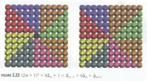

You can find analogous visual proofs, similar to assembling puzzle pieces, in Conway and Guy's The Book of Numbers, e.g. the following one about triangular numbers.
