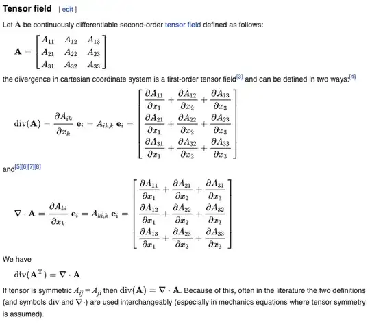

  • what about more general case: divergence of second-order tensor field - here ? – Kamil Kiełczewski Jan 03 '23 at 10:42

Interpretation of divergence as gradinet transposition, can be challanging especially for case of second-order tensor field - where whe can define it in two ways... - cite from wiki:
