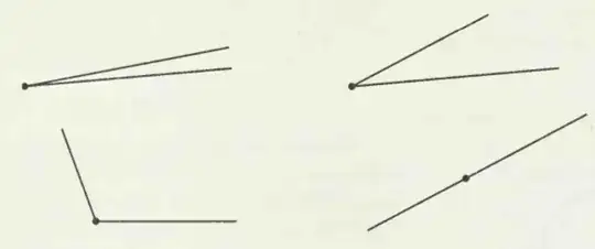

The idea of an angle is as simple as the union of two half-lines with a common initial point. enter image description here

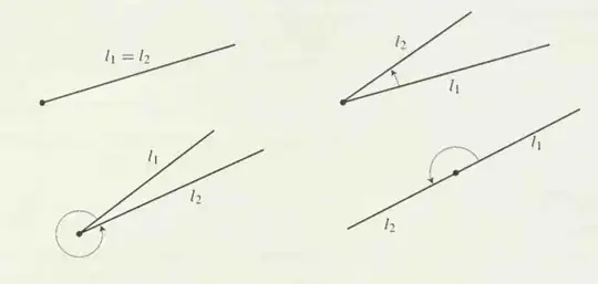

A directed angle can be thought of as a pair of half lines with the same initial point
Okay, not sure what the difference is between the two.

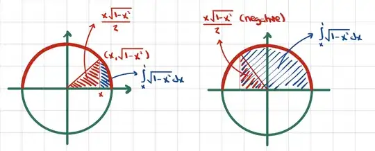

Then, an area function is defined.
$$A(x)=\frac{x\sqrt{1-x^2}}{2}+\int_x^1 \sqrt{1-t^2}dt$$
This is just the function giving the area of a sector of the unit circle given an x-coordinate:
This function has certain characteristics: it is continuous on $[-1,1]$, is decreasing and hence one-one.
So at this point $\cos x$ is defined as the unique number in $[-1,1]$ such that
$$A(\cos{x})=\frac{x}{2}\tag{1}$$ and $\sin{x}$ is defined as
$$\sin{x}=\sqrt{1-\cos^2{x}}$$
