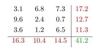

Now, take the following matrix as an example:

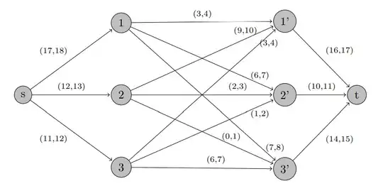

The transformation into a max flow problem comes with the following graph:
And my question now is pretty simple... Take for example the node $1$. It receives $17$ amount of flow and only gives away $3+6+7 = 16 \neq 17$. On the other hand, take the node $1'$ for example. It receives $3+3+9 = 15$ and it gives away $16$. I believe this doesn't agree with the basic properties I introduced earlier.
Is there any explanation for this?

  • Those numbers are the possible values for the flow. So it has 17 or 18 as possible inputs and 16, 17, 18, or 19 as possible outputs. Since these sets aren't disjoint, everything's fine. – eyeballfrog Jul 06 '22 at 20:28
  • How do you define the capacity of an arch $(i,j)$ then? For example, If I wanted to apply Ford Fulkerson algorithm, what would be the capacity of the arch $1$? – xyz Jul 06 '22 at 20:31
