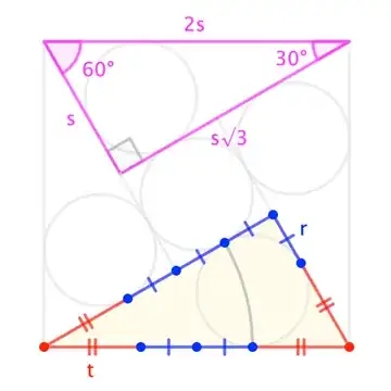

Edit. (Almost a duodecade later!) Combining and streamlining my previous arguments (now consigned to the Edit History) ...
The figure shows that the right triangle's hypotenuse (ie, $2r+2t$) is twice the length of its short leg (ie, $r+t$), hence we have a $30^\circ$-$60^\circ$-$90^\circ$ triangle.
The inradius can then be calculated from standard formulas, or we can continue to leverage the figure and write
$$2r = \underbrace{(3r+t)}_{\text{long leg}}-\underbrace{(r+t)}_{\text{short leg}} \qquad\to\qquad r = \frac{s}{2}\left(\sqrt{3}-1\right)$$ where $s$ is half the length of the side of the square. $\square$

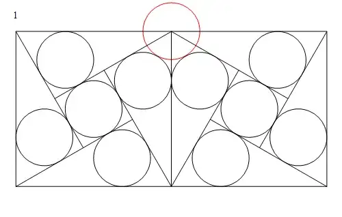

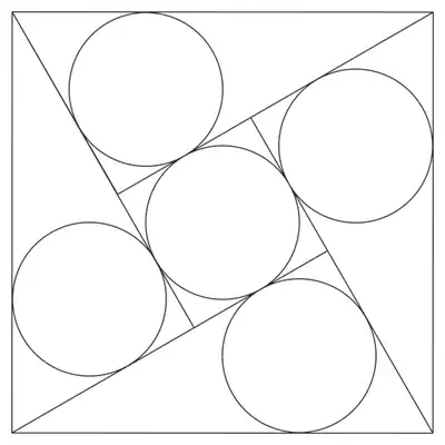

Here is my attempt at a purely geometric approach:
                    sangaku
Arrange a set of equal-size circles as in image 2, and position the top and bottom circles so that their centers form one side of a square. From the four-fold symmetry, it is seen that the left-most circle is in the center of the square, and since the altitude to the equilateral triangle is tangent to each of the two circles and is perpendicular to the side of the triangle in image 3, it follows that the left and right circles, and the two central circles just above these, are coincident with those from the original diagram in image 1 (and of course the images have been aligned to convince you of this as well). Thus all that remains is to measure $r$; in image 4 we note that the side of the triangle, which has length $1$, is also length $(2+2\sqrt3)r$ (the $\sqrt3$ measurements come from this being an equilateral triangle); from this we get
$$r=\frac1{2(1+\sqrt3)}=\frac{\sqrt3-1}4.$$

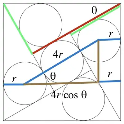

Let $r$ be the length the radius of the circles, and let $\theta$ be the measure of the (smaller) angle made at the corner of the big square.
Labeled image
The width of the square is equal to two radii and the projection of a double diameter (a quadruple-radius), so that
$(1)\hspace{1.0in}4r\cos\theta=1-2r$
Looking at the four right triangles, we see that the center circle's diameter is equal to the difference in the lengths of the legs; since the hypotenuse has length $1$, we have
$(2)\hspace{1.0in}2r = \cos\theta - \sin\theta$
From here, we simply need to eliminate $\theta$.
Multiplying (2) through by $4r$ and substituting in from (1) ...
$$8 r^2 = 4r\cos\theta - 4r \sin\theta = 1 - 2r - 4r \sin\theta$$ $$4r \sin\theta = 1 - 2r - 8 r^2$$
Therefore,
$$\begin{eqnarray}16r^2 &=& (4r \cos\theta)^2 + (4 r \sin\theta)^2 \\\ &=& ( 1 - 2r )^2 + ( 1 - 2r - 8 r^2 )^2 \\\ &=& 2 - 8 r - 8 r^2 + 32r^3 + 64 r^4 \end{eqnarray}$$
so that
$$0 = 32 r^4 + 16 r^3 - 12 r^2 - 4 r + 1 = (2r+1)(2r-1)(8 r^2 + 4 r - 1)$$
The roots of the polynomial are $\pm1/2$ and $(-1\pm\sqrt{3})/4$. We can eliminate three of them from consideration to conclude that $r = (-1+\sqrt{3})/4$.

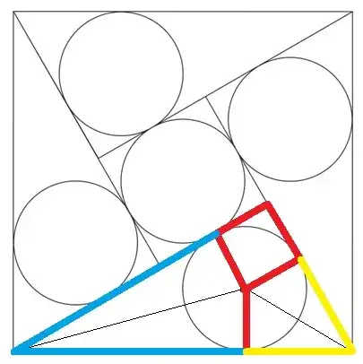

Picture with couloured line
In the picture above, let the red lines have lengths $r$, and the blue lines have lengths $x$. Then the yellow lines have lengths $1-x$.
From Pythagoras: $$(x+r)^2+(1-x+r)^2=1^2$$ Which simplifies to: $$r+r^2=x-x^2$$ Considering the area of the outer square as the sum of 4 rectangles and the inner square: $$4\cdot\frac{1}{2}\cdot(x+r)(1-x+r)+(2r)^2=1^2$$ Which simplifies to: $$2(x-x^2+r+r^2)+4r^2=1$$ Subbing in the previous expression: $$2(r+r^2+r+r^2)+4r^2=1$$ Which simplifies to: $$8r^2+4r-1=0$$ Solving for the positive root: $$r=\frac{\sqrt{3}-1}{4}$$
