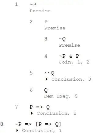

What would have happened if $P \implies Q$ was taken false when $P$ was false and $Q$ was true?
To avoid inconsistencies, at the very least, you would have to invalidate at least one step in the following proof that $\neg P \implies [P \implies Q]:\\$
(Screenshot from my proof checker)
You might, for example, have to disallow or somehow restrict proof by contradiction (line 5), or elimination of '$\neg\neg$' (line 6).
  • I note your sentence is a classical equivalent of explosion. Under OP's changed rule for "$\implies$", can you add a derivation of an inconsistency (contradiction?) from it, which you mention? Secondly, regarding the proof checked program, which I don't know: How/Why does $\neg Q$ appear as assumption in the third line? – Nikolaj-K May 15 '22 at 09:09
  • @Nikolaj-K You want to prove $P\implies Q$. You introduce the premise $P$ on line 2, and suppose to the contrary that $\neg Q$ on the next line. You obtain a contradiction on line 4 and conclude $\neg\neg Q$ on line 5, thus discharging the premise on line 3. – Dan Christensen May 16 '22 at 15:06
  • Okay, I see. So it's because it lets you introduce ¬ and then negating it, without in any way using it. Anyway, to the second question - what inconsistency do you mean in the answer? – Nikolaj-K May 16 '22 at 19:43
  • @Nikolaj-K If you want to somehow ban the use of vacuous truth, you will have to somehow make it impossible to derive the above result, and perhaps other results as well. – Dan Christensen May 16 '22 at 21:27
  • I'm actually not sure if I follow. What I can say is that the proposition you prove in this answer is not adopted or provable in all paraconsistent logics, but I don't at once see why it's not consist with OP's notion of entailment. – Nikolaj-K May 17 '22 at 19:48
  • @Nikolaj-K IIUC the OP is suggesting that $\neg P \land Q \implies \neg (P \implies Q)$ be an axiom or theorem of propositional logic. Using the basic rules of logic, however, we can obtain $\neg P \land Q \implies (P \implies Q)$. These results are not consistent. Can't comment on "paraconsistent" logic. – Dan Christensen May 18 '22 at 21:17
  • Well, OP stated an idea of how entailment could be evaluated. Your syntatic characterization of what he said, as an implication sentence in the object language, $\neg P\land Q\implies \neg(P\implies Q)$, seems tricky. Could OP agree with adopting this sentence as an (always true) axiom, to express his idea of how entailment should be evaluated? I doesn't seem so: Whenever $P$ is true or $Q$ is false, that sentence itself (now of the form $F\implies T$) would have be considered false by OP's idea of how entailment should be evaluated. – Nikolaj-K May 20 '22 at 16:19
