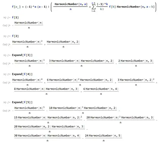

First let me introduce the two recursive relations:
$$\int_0^1 x^{n-1}\ln^a(1-x)dx=f(a,n),$$
where
$$f(a,n)=(a-1)!\sum_{j=0}^{a-1}\frac{(-1)^{a-j}}{j!}f(j,n) H_n^{(a-j)},\quad f(0,n)=\frac1n.\tag{1}$$
Cases using Mathematica:
graph1

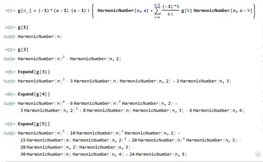

$$(-1)^a\frac{\ln^a(1-x)}{1-x}=\sum_{n=0}^\infty g(a,n) x^n,$$
where
$$g(a,n)=-(a-1)!\sum_{j=0}^{a-1}\frac{(-1)^{a-j}}{j!}g(j,n)H_n^{(a-j)},\quad g(0,n)=1.\tag{2}$$
graph2
Question: Are $(1)$ and $(2)$ known in the literature? If so, any reference?
