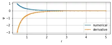

For large $r$ the equation gets close to $$ ψ''=\sinhψ\implies ψ'^2=2\coshψ+C $$ and with the asymptotic convergence at infinity $C=-2$ so that $$ ψ'^2-(2\sinh(ψ/2))^2=0. $$ The desired stable behavior for the far-field solution corresponds to the factor $$ψ'+2\sinh(ψ/2)=0.$$ This can be taken as upper boundary condition at some largish but finite upper interval end.
Let's try an example with $ψ(0.5)=1$.
def sys(r,u):
    ψ,θ = u
    return θ, sinh(ψ)-2*θ/r
def bc(ua,ub): ψa,θa = ua ψb,θb = ub return ψa-1, θb+2*sinh(ψb/2)
a,b = 0.5, 5 r = a+logspace(-3,0,10)(b-a) u = [1-r/b, -1/b+0r]
res = solve_bvp(sys,bc,r,u)
This works and gives a simple falling and asymptotic curve
