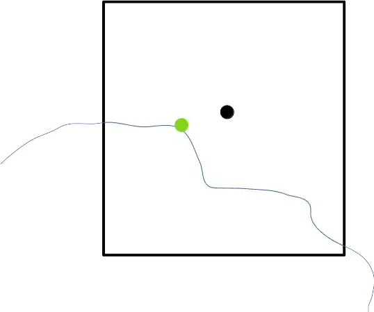

The problem is as follows, you have an implicit function $f:\mathbb{R}^2 \rightarrow \mathbb{R}$.
You have a square region that overlaps with the boundary of the surface described by the iso line $f(x, y) = 0$.
You want a point that is on the surface and that is as far as possible from the boundaries which is equivalent to saying you want it to be as close as possible to the cell center.
If we draw a picture: enter image description here
The blue curve is the iso surface, the black point the center of the square, the green point a good candidate point.
