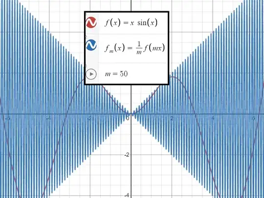

    The apparent solid triangles in your $a ,x\sin(x)$ example is not actually solid or space-filling. When you zoom out, you seem to be seeing the width of the curve being meaningful rather than negligible – Henry Feb 17 '22 at 12:35
  • @Henry that seems reasonable to me, after all, after all in the limit all the points converge to 0, 0. However, I still would want to know some mathematical way to express what I'm seeing, perhaps by imagining the lines are of a thickness that decreases as the zoom increases, and thus get arbitrarily close to 0 width. One might say that this is a pseudo space filling curve, and then ask what space it pseudo-fills. – MilesZew Feb 17 '22 at 23:47

For $y = x \sin x$ specifically, as you observed it resembles two large triangles, which together can be described as the set of points $T = \{(x,y) : -|x| \leq y \leq |x|\} \subset \mathbb R^2$. To argue that the graph $ty = tx \sin tx$ somehow "approaches" or "converges to" $T$ as $t \to \infty$ requires some notion of what it means for a family of subsets of $\mathbb R^2$ to "approach" or "converge to" another subset. There are many ways to interpret this idea, and some will be more useful than others in certain contexts.
My first guess to formalize this idea might go something like this: let $G_t = \{(x,y) : f(tx,ty) = 0\}$ be the graph of the desired function at the scale $t$. We will say the family of subsets $G_t$ "approaches" or "converges to" the subset $S \subset \mathbb R^2$ if it holds that $(x,y) \in S$ if and only if there is a sequence $(t_n)_n$ such that $t_n \to \infty$ as $n \to \infty$, as well as a sequence of points $(x_n,y_n) \in G_{t_n}$ such that $(x_n,y_n) \to (x,y)$ as $n\to \infty$.
With this definition, we can prove that the graph of $y = x \sin x$ approaches the two-triangles set $T$. Here is the argument:
Let $(x,y) \in T$ be arbitrary, ie $-|x| \leq y \leq |x|$ or equivalently $-1 \leq y/x \leq 1$. There is therefore a value $\theta > 0$ such that $y/x = \sin(\theta + 2\pi n)$ for all $n$, or equivalently $y = x \sin (\theta + 2\pi n)$.
So let $(t_n)_n$ be the sequence such that $t_n = \frac1x(\theta + 2\pi n)$ for each $n$ (in the case that $x \geq 0$; in the case that $x < 0$, replace $t_n$ by $-t_n$), and let $(x_n,y_n)_n$ be the constant sequence $(x,y)$. Then clearly $(x_n,y_n)_n \to (x,y)$ as $n\to \infty$, and moreover $y_n = x_n \sin (t_n x_n)$ for each $n$, ie $(x_n,y_n) \in G_{t_n}$ for each $n$.
In the converse case, suppose $(x,y) \not\in T$, ie $y/x < -1$ or $y/x > 1$. Then we want to show there is no sequence of times $t_n$ and points $(x_n,y_n) \in G_{t_n}$ such that $t_n \to \infty$ and $(x_n,y_n) \to (x,y)$ as $n \to \infty$. We can use a little topology to argue this.
Note that $G_t \subset T$ for every $t > 0$, and $T$ is a closed subset of $\mathbb R^2$. This means there can be no sequence of points from $T$ converging to $(x,y)$, if $(x,y) \not\in T$.
This completes the proof, and so we can say that the graph of $y = x\sin x$ does indeed converge to the subset $T$ of two triangles as you zoom out infinitely far (relative to the definition above).

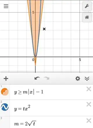

Using this definition, here is a proof that the graph of $y = x^2$ converges to the half-line $\{(0,y) : y \geq 0\}$ as one zooms out infinitely far.
In this case, $G_t = \{(x,y) : ty = (tx)^2\}$ or equivalently $y = tx^2$. So pick an arbitrary $y \geq 0$, in which case for each $t > 0$ one can let $x = \sqrt{y/t}$. For this $x$ and $y$ it holds that $(x,y) \in G_t$, and therefore
$$d\big((0,y), G_t\big) \leq x = \sqrt{y/t}.$$
Using the squeeze theorem, we then see that $d\big((0,y), G_t\big) \to 0$ as $t \to \infty$. This demonstrates that $\{(0,y) : y \geq 0\} \subset \lim_t G_t$. For the reverse inclusion, we would need to argue that any point $(x,y)$ with $x \neq 0$ or $y < 0$ must stay "bounded away" from the set $G_t$ for all sufficiently large $t$.
We can make use of a simple lemma: if $A_t$ is a descending family of closed subsets such that $G_t \subset A_t$ for each $t$, then $\lim_t G_t \subset \bigcap_t A_t$. This is true because, for any point $(x,y) \not\in \bigcap_t A_t$, it holds that $(x,y) \not\in A_t$ for all sufficiently large $t$ - and, because each $A_t$ is closed, any point outside of $A_t$ is a positive distance away from $A_t$.
Say, for instance, $(x,y) \not\in A_{t_0}$ and observe $G_t \subset A_t \subset A_{t_0}$ for all $t \geq t_0$. We also have, because $A_{t_0}$ is closed, that $(x,y) \not\in A_{t_0}$ implies $d\big((x,y),A_{t_0}\big) > 0$. Hence
$$d\big((x,y), G_t\big) \geq d\big((x,y), A_{t_0}\big) > 0$$
for all $t \geq t_0$, and therefore $d\big((x,y),G_t\big) \not\to 0$ as $t \to \infty$.
We can apply this lemma to our problem here in the following way. For each $t > 0$, let $A_t = \{(x,y) : y \geq 2\sqrt{t}|x| - 1 \text{ and } y \geq 0\}$. Observe that $(A_t)_t$ is a descending family of subsets and $G_t \subset A_t$ for each $t$. By the lemma above, we then have that
$$\lim_{t\to\infty} G_t \subset \bigcap_{t>0} A_t = \{(0,y) : y \geq 0\}$$
This completes the proof that the graph of $y = x^2$ converges to the half-line $x = 0$, $y \geq 0$ as one zooms out infinitely far. See below for an illustration of $G_t$ and $A_t$ for a particular $t$ value. The idea is that we overapproximate the graph $G_t$ by a sort of triangular cone shape (also implicitly restricting to the upper half-plane).
The reason why $\bigcap_t A_t = \{(0,y) : y \geq 0\}$ is clear from the picture; as $t \to \infty$, the slope of the boundary goes to infinity as well, and so it will "sweep past" any point $(x,y)$ with $x \neq 0$, in which case $(x,y)$ has no hope of belonging to the intersection.

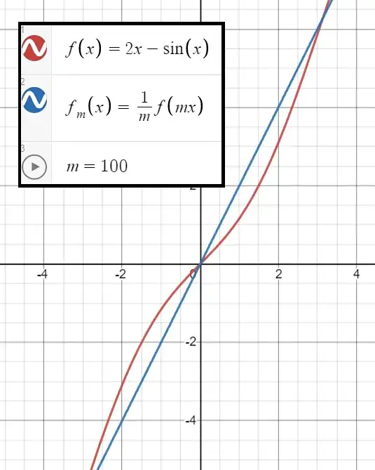

Take, for instance, the function
$$f(x) = 2x - \sin(x)$$
It easy to see that
$$f_m(x) = \frac 1 m \Big( 2mx - \sin(mx) \Big) = 2x - \frac 1 m \sin(mx)$$
and since $\sin(mx) \in [-1,1]$ for all $m,x \in \mathbb{R}$, that contribution gradually becomes "irrelevant": this is because when $m$ is large, we'll have a value in $[-1,1]$ divided by a large number, so it doesn't matter. Hence in the limit,
$$\lim_{m \to \infty} \left( 2x - \frac 1 m \sin(mx) \right) = 2x = f_\infty(x)$$
and of course, graphing these and trying large $m$ in the demo appears to confirm that: as $m$ increases, the blue graph approaches a line of slope $2$ which goes through the origin.

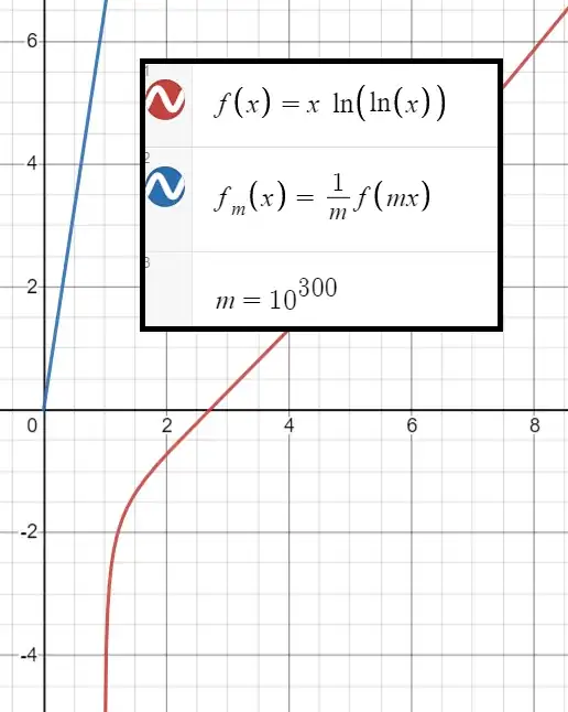

Another example you messed with observed behavior of basically becoming a straight, vertical line. This one is harder to codify, but it can be looked at in a slightly hand-wavier way.
Say a line pops up at $x=0$ for the zoomed-out function for a large magnification factor. (Not necessarily $f_\infty$, just imagine zooming out manually.) What this essentially can be seen as is, for inputs relatively near zero, the values of the function near that point increase far faster (when accounting for zoom) than the inputs might as they increase.
If we have a line elsewhere, at $x=x_0$, then in the zooming process the line no longer stays at $x_0$, but moves along: at a magnification of $m$, it will "appear" to be where $x_0/m$ was. Of course, for large $m$, it will appear to be at zero if it appears at all.
This suggests to me, somewhat crudely, that vertical line can appear at zero if the function grows faster than $\mathcal{O}(|x|)$ (since the derivative of $f_m$ is $f_m'(x) = f'(x)$ but we also want to account for growth in either direction, hence the modulus).
This at least seems to be true with the cases I tried (common roots and polynomials, exponentials), and the fact that $f(x) = x \ln(x)$ or even $f(x) = x \ln(\ln(x))$ seems to be exhibiting that behavior but taking extraordinarily large $m$ to do so seems to help corroborate the idea.
$f(x) = x \ln(\ln(x))$ is especially a powerful point because if you have absurd exponents in Desmos and make likewise absurd changes (e.g. $10^{200}$ to $10^{300}$ for $m$) you will see a nudge but it is so slow.

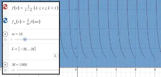

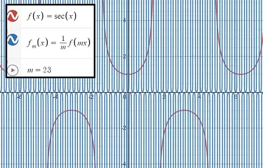

Finally, you also made a point about functions that "look like the entire plane," with $\tan(x)$ being the example.
  • The core criterion for this is periodicity, so you can smoothly cover the plane.
  • You also need to map to most of the reals. Not all of them need to be mapped to, but a good chunk do. I'm not entirely sure how to codify how much needs to be mapped to, however. I have this idea in my mind of a function that, as $m$ grows, it starts missing vertical stripes for whatever reason and doing so periodically. So there is some behavior, I believe, that needs to be nailed down further.
Some simple examples of this would be $\sec(x)$ and $\csc(x)$:
You can even go with "periodic extensions" if you don't want to do trigonometric functions, though they're a bit more annoying to implement in Desmos. Say for instance we define
$$f(x) = \begin{cases} 1/x & x \in (0,1] \\ 1/(x-N) & x \in (N,N-1], \text{for } N \in \mathbb{Z} \setminus \{1\} \end{cases}$$
(the idea being to take the segment of $1/x$ on $(0,1]$ and spread it everywhere). Then, playing with Desmos (e.g. limiting our $N$ to a range of $[-M,M] \cap \mathbb{Z}$ for simplicity and so it doesn't set my computer on fire), we can see something like this:
Of course, the fact that it doesn't hit the whole plane, and just the top half, is simply an artifact of the function being always positive. A similar idea comes with your other example of $f(x) = x \sin(x)$; the function is always stuck between $y = x$ and $y=-x$, and otherwise will generally hit every value eventually. Hence, zooming out looks like filling in the gaps between $y = x, y=-x$:
It all ultimately just depends on where your function's graph lives and what bounds it.
