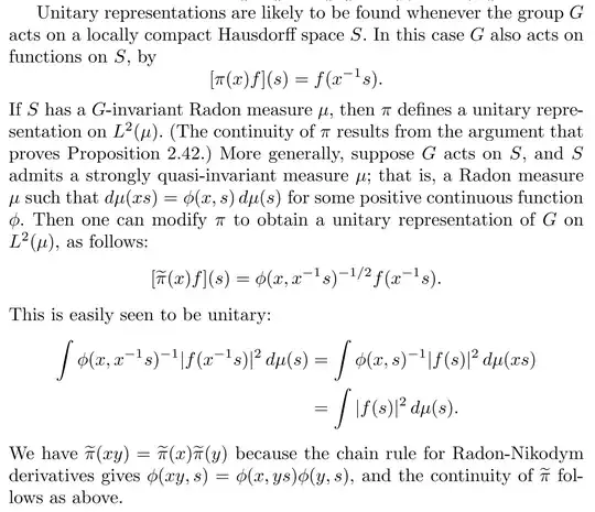

Consider the following fragment (p.74) from Folland's book A Course in Abstract Harmonic Analysis (2e):
My question is simple:
What is the right handed situation of the above? I.e. suppose that $G$ acts on the right on the locally compact hausdorff space $S$ such that $$d \mu(sx) = \phi(x,s) d\mu(s).$$
My guess is that we then have that $$[\widetilde{\pi}(x)f](s)= \phi(x^{-1}, sx)^{-1/2} f(sx).$$
Can someone confirm this?
Note that we have \begin{align*}\int_S |\phi(x^{-1}, sx)^{-1/2}f(sx)|^2 d\mu(s)&=\int_S \phi(x^{-1},sx)^{-1} |f(sx)|^2 d\mu(s)\\ &=\int_S \phi(x^{-1},t)^{-1}|f(t)|^2 d\mu(tx^{-1})\\ &= \int_S \phi(x^{-1},t)^{-1}|f(t)|^2 \phi(x^{-1},t) d \mu(t)\\ &= \int_S |f(t)|^2 d \mu(t)\end{align*} which seems to confirm my guess, but wanted to make sure I didn't miss anything!
Alp Uzman
  • 12,209
Andromeda
  • 947
You seem to be right.
