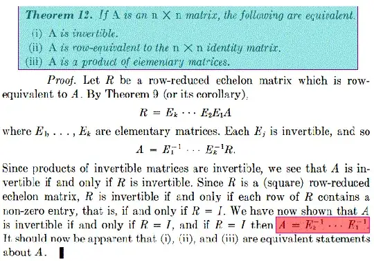

8
(Red highlight Typo in Linear Algebra by Hoffman and Kunze, page 23)
It should be $$A=E_1^{-1}E_2^{-1}...E_k^{-1}$$
Let $A=\left[\begin{matrix}2&3\\4&5\end{matrix}\right]$
Elementary row operations:
$R_2\leftrightarrow R_2-2R_1, R_1\leftrightarrow R_1+3R_2, R_1 \leftrightarrow R_1/2, R_2 \leftrightarrow R_2*(-1)$ transforms $A$ into $I$
These four row operations on $I$ give
$E_1=\left[\begin{matrix}1&0\\-2&1\end{matrix}\right]$, $E_2=\left[\begin{matrix}1&3\\0&1\end{matrix}\right]$, $E_3=\left[\begin{matrix}1/2&0\\0&1\end{matrix}\right]$, $E_4=\left[\begin{matrix}1&0\\0&-1\end{matrix}\right]$
$E_1^{-1}=\left[\begin{matrix}1&0\\2&1\end{matrix}\right]$, $E_2^{-1}=\left[\begin{matrix}1&-3\\0&1\end{matrix}\right]$, $E_3^{-1}=\left[\begin{matrix}2&0\\0&1\end{matrix}\right]$, $E_4^{-1}=\left[\begin{matrix}1&0\\0&-1\end{matrix}\right]$
Now, $ E_1^{-1}.E_2^{-1}.E_3^{-1}.E_4^{-1}=\left[\begin{matrix}2&3\\4&5\end{matrix}\right]$
but, $ E_4^{-1}.E_3^{-1}.E_2^{-1}.E_1^{-1}=\left[\begin{matrix}-10&-6\\-2&-1\end{matrix}\right]$
Vikram
  • 5,808
  • On page 18 "If $B$ is an n X p matrix, the columns of $B$ are the 1 X n matrices $B_1, . . . ,B_p$ defined by ..." in this line it should be rows instead of columns – Vikram Jun 16 '17 at 08:19
  • Rather, in this line it should read "...the columns of $B$ are the $n \times 1$ matrices...". –  Sep 16 '17 at 12:08
