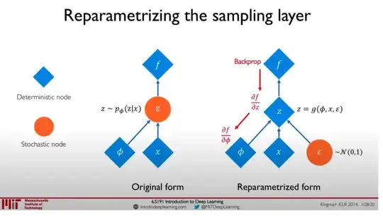

In's commonly said that in VAE, we use reparameterization trick because "we can't backpropagate through stochastic node" enter image description here
It makes sense from the picture, but I found it hard to understand exactly what it means and why. Let's say X ~ N(u, 1).

I think you are confused about back propagation. You never need to take the gradient of the input with respect to anything (because there is no layer BEFORE the input), nor do you need to make assumptions about the distribution of the input.
The 'reparametrization trick' makes some assumption about the parametric form of the distribution of the latent vector $z$, and represents sampling from that latent space as the output of some function of the parameter values and a noise vector. That allows you to backprop through the latent vector $z$ by taking the gradient of it with respect to the parameter values.
For example, if $z$ is assumed to be multivariate Gaussian, then $z_i = \mu_i + \sigma_i \epsilon_i$, where $\epsilon_i \sim N(0,1)$, and $$\frac{\partial z_i}{\partial \mu_i} = 1$$ $$\frac{\partial z_i}{\partial \sigma_i} = \epsilon_i$$ The vectors $\mu$ and $\sigma$ are learned, i.e. they are connected to the previous layer in the network, and you can backprop through them in the usual way. The random noise $\epsilon$ is drawn from a fixed distribution, not learned, so you do not backprop through those nodes (which is why it is orange in your diagram).
