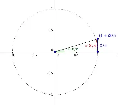

Consider $(1+iX/n)$, where $n$ is sufficiently large so that $X/n$ is small. On the complex plane, it corresponds to the point $(1, X/n)$. The arc (red in figure above) subtended by this point and the real line is of length approximately $X/n$ units when $X/n$ is small. So the angle at the origin, which in radians is the same as the arc length, is also approximately $X/n$. Further, the modulus/absolute value of $(1+iX/n)$ (its distance from origin), is roughly $1$. I presume you know that multiplying by a complex number which has unit modulus and angle/argument $\theta$ is rotation by $\theta$. So here, multiplying by $(1+iX/n)$ is roughly a rotation by $X/n$. Multiplying by $(1+iX/n)^n$ is therefore roughly rotating by $X/n$ $n$ times, that is, rotation by $X$. As $n \to \infty$, this becomes exact.

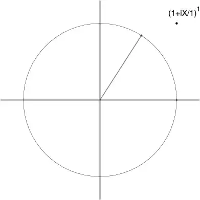

Here's an illustration showing $(1+iX/n)^n$ (and also $(1+iX/n)^k$ for $k < n$) as $n$ increases. (This illustration is for $X=1$, but it's similar for any $X$.) You can see that as $n$ becomes large, $(1+iX/n)^n$ aproaches the point that on the circle that is at angle $X$, i.e. the point that correponds to rotation by $X$. (Although you didn't want $e$, $\sin$ or $\cos$ used in the explanation, it may be worth mentioning for future reference that this point on the circle is the same as $e^{iX}$ or $\cos X + i\sin X$.)
For X=1

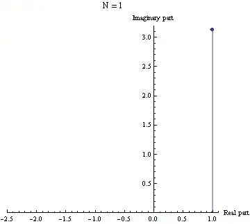

Here's an animation from Wikipedia that shows the first $n$ powers of $1+\dfrac{i\pi}{n}$ for larger and larger and larger values of $n$:
The idea is that, if $\theta$ is a small angle, then $1 + i\theta$ has a modulus of approximately 1 and an argument of approximately $\theta$. This follows from the linear approximations $$ \arctan\theta \approx \theta \qquad\text{and}\qquad \sqrt{1+\theta^2} \approx 1 $$ which become more and more accurate the smaller the value of $\theta$. It follows that the powers of $1 + i\theta$ all have modulus approximately $1$, and have arguments that are multiples of $\theta$.
In particular, since $1+\dfrac{iX}{n}$ has an argument of approximately $X/n$ and a modulus of approximately $1$, the quantity $\left(1+\dfrac{iX}{n}\right)^n$ has an argument of approximately $X$ and a modulus of approximately $1$. As you can see from the animation, this approximation becomes more and more accurate as $n$ increases.

  • Thanks! I don't quite understand the image above: I understand the first frame represents $1 + i*\pi$, but I don't understand the following frames. I know I'm being a bit dense, but could you break frame 3 down for me into what each segment represents? – Nate Jun 06 '11 at 02:17
    @Nate: The segments are immaterial -- they're just there to make it easier to see where the endpoints are. The endpoints of the segments are the first $n$ powers of $(1+i\pi/n)$. For example, in the third frame, the three points are $(1+i\pi/3)$, $(1+i\pi/3)^2$, and $(1+i\pi/3)^3$. – Jim Belk Jun 06 '11 at 02:40
