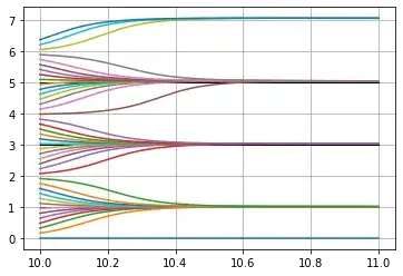

A suitable numerical visualization confirms this result, the plot below contains the plots of $xy(x)/\pi$ for several initial values $y(10)$. It is well visible that there are attracting lines close to the odd integers while the even integers are unstable.

  • Ah, I see, thank you. Also another question: I don't really understand why considering $xy\approx(2n+1)\pi$ is sufficient to make a conclusion about the limit of $y$. Firstly, isn't it possible that $xy$ is never close enough for the approximation to give reasonable results? Like if $xy$ oscillates around $2\pi$ for example, this doesn't seem plausible, yet it is not obvious to me, why this could not be the case. Also even if there are such points, why talking only about them is enough? Maybe between those the function is not close to 0 and the limit doesn't exist at all – jabuj Dec 22 '21 at 18:05
  • But then the result would still hold. If $xy$ never comes close to an odd multiple of $\pi$, then this value is bounded between the next two such multiples. Oscillation means crossing, which is also not possible without coming close. As the plot shows, $x=10$ is already sufficiently large to invoke the approximation of the Dawson function, even $x=5$ is sufficient. $x=1$ is too small. – Lutz Lehmann Dec 22 '21 at 18:14
