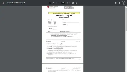

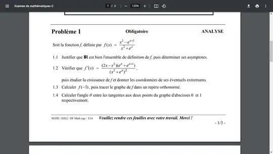

I found this question in a " maturité" test ( Swiss high school final exam), dating from $2014$ :
Let $\LARGE f $ be a function defined by : $\LARGE f(x)= \frac {x^2 - e^{x+1}} {x^2 +e^x}$ . Justfy that $\mathbb R$ is the domain of $\LARGE f$ and determine the asymptotes of function $\LARGE f$.
