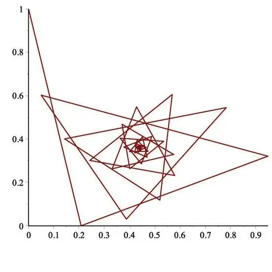

We had this question quite recently, as I recall. But I cannot now find it. Anyway, here we see $a_n$ for $n$ from $1$ to $50$. They are converging, right?
The limit is: $$ \frac{2i}{\pi}W\left(\frac{-i\pi}{2}\right) \approx .4382829366+.3605924718 i $$ Of course $W$ is the Lambert W function.
