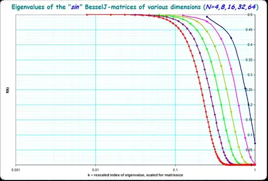

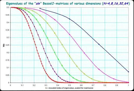

- How to stabilize the diagonalization of this "Bessel Matrix" : practically it works well, but eigenvalues / vectors vary wildly when dimensions change. Is there a way to "order" the eigen values so the diagonalization process somehow converges ?
- Do I have a way to get an approximation of the coefficient of $\sin(x)$(resp $\sin(3x) $ etc. as a function of n ? Numerical approximation gives $\sin^n(x) = [0.67 \cdot 0.98^n + 0.34 \cdot 0.757^n ] \sin(x) + [0.12 \cdot 0.98^n - 0.10 \cdot 0.757^n - 0.17 \cdot 0.282^n ] \sin(3 x)+...$ but this seems very dependent upon the dimension used during diagonalization.
- How can I choose the dimension to "cap" the error on the iterate sin to a certain level, etc.
