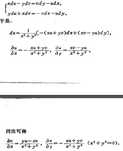

Find $\frac{\partial u}{\partial x}, \frac{\partial u}{\partial y}, \frac{\partial v}{\partial x}$, if $xu-yv=0$ and $yu+xv=1$
Actually, I have an answer but I don't understand anything. Not because it is Chinese but transformations. Could you explain?

1What have you tried so far? – Brian Borchers Oct 21 '21 at 17:33
1$v=\frac{x}{y}u$, substitute into the second equation and differentiate – Vasili Oct 21 '21 at 17:35
2"not because it is Chinese": I appreciate your humor... – Jean Marie Oct 21 '21 at 17:36
1Using the product rule, $(xu-yv)'=xdu+udx-ydv-vdy=0$. Do you get it now? – Vasili Oct 21 '21 at 17:41
@Vasya this thing I understood – sln Oct 21 '21 at 17:42
@Vasya but why in the second system the equation is like this – sln Oct 21 '21 at 17:44
1OK, $(1)'=0=(yu+xv)'$ – Vasili Oct 21 '21 at 17:45
@Vasya oh, I understand – sln Oct 21 '21 at 17:46
@Vasya but by which variable do we differentiate? Or is it a formula without differentiating variable? – sln Oct 21 '21 at 17:48
1@kfcgenius: This is called implicit differentiation because we do not have a function that depends on some variables but an equation. Thus, we do not differentiate using a specific variable. – Vasili Oct 21 '21 at 17:54

The first set of equations:
$$\begin{cases}xu-yv&=&0\\yu+xv&=&1\end{cases} \tag{0}$$
can be differentiated under the form:
$$\begin{cases}(udx+xdu)-(vdy+ydv)&=&0\\(u dy +y du)+(vdx+xdv)&=&0\end{cases},$$
giving the equivalent system:
$$\begin{cases}xdu-ydv&=&-udx+vdy\\ ydu+xdv&=&-vdx-udy\end{cases} $$
as in your book. Now, write it with matrices and vectors:
$$\underbrace{\begin{pmatrix}x&-y\\y&x \end{pmatrix}}_A\begin{pmatrix}du\\dv \end{pmatrix}=\underbrace{\begin{pmatrix}-u&v\\-v&-u\end{pmatrix}}_B \begin{pmatrix}dx\\dy \end{pmatrix}$$
from which you deduce that :
$$\begin{pmatrix}du\\dv \end{pmatrix}=\underbrace{A^{-1}B}_J \begin{pmatrix}dx\\dy \end{pmatrix}$$
It remains to compute matrix $J$:
$$J=\dfrac{1}{x^2+y^2}\begin{pmatrix}x&y\\-y&x \end{pmatrix}\begin{pmatrix}-u&v\\-v&-u\end{pmatrix}$$
$$J=\dfrac{1}{x^2+y^2}\begin{pmatrix}(-ux-vy)&(vx-uy)\\(uy-vx)&(-ux-vy)\end{pmatrix}\tag{1}$$
Remark: We have used the classical formula for the inverse of a $2 \times 2$ matrix.
$J$ is the jacobian matrix of the transformation $(x,y) \to (u,v)$, whose entries are precisely:
$$J=\begin{pmatrix}\frac{\partial u}{\partial x}&\frac{\partial u}{\partial y}\\\frac{\partial v}{\partial x}&\frac{\partial v}{\partial y} \end{pmatrix}\tag{2}$$
It remains to identify the corresponding entries in (1) and (2).

And if both equations in system are both equals to 0, can I just unite them in one equation? – sln Oct 21 '21 at 18:06
1You could treat a single system by using complex numbers, but, as you can see, with the method I propose you, you reach the result. – Jean Marie Oct 21 '21 at 18:08
Because the formula for the inverse of a matrix $A$ begins by $\frac{1}{\det(A)}$ – Jean Marie Oct 21 '21 at 18:16
