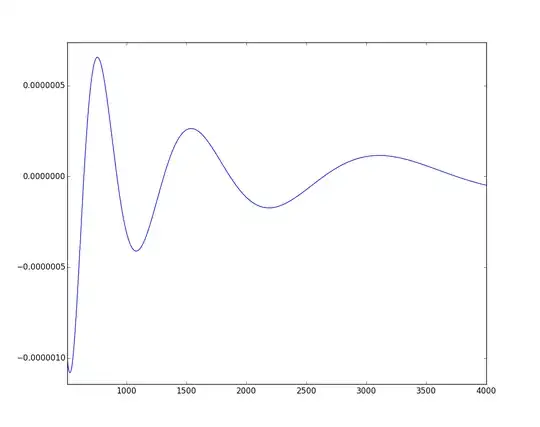

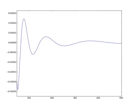

A plot of the deviation between the percentage of gap-free compositions from $\frac12$ for $50 \leqslant n \leqslant 4000$ is quite remarkable.
enter image description here $50 < n < 500$
enter image description here $500 < n < 4000$
Not only does it seem to converge quite rapidly, it also shows a strange oscillating behavior.
