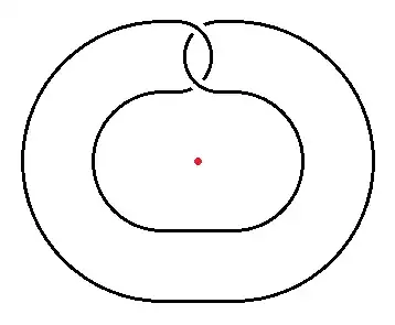

Here's one manifold counterexample in three dimensions:
Let $X=\left(\mathbb{R}^2\setminus\{0\}^2\right)\times\mathbb{R}$ be $\mathbb{R}^3$ sans the $z$-axis, and consider the embedding $S^1\to X$ given in the following "knot diagram":
Where the $z$-dimension is suppressed. The loop is clearly contractible, but it cannot be contracted in the desired manner. To see this, suppose such an $H$ exists, and note that $\gamma_t$ is an unknot in $\mathbb{R}^3$ for all $t<1$, and there is an $\epsilon>0$ such that $\gamma_{1-\epsilon}$ is contained in an open ball disjoint from the $z$-axis. Adding a point at infinity, $H|_{S^1\times[0,1-\epsilon]}$ then becomes an isotopy which unlinks the Whitehead link, which is a contradition.
