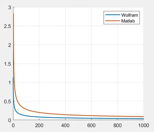

Plotting both results using
w = 0:1:1000;
H1 = ((1+i)*exp(-i*pi/4).*(sign(w+1)+1))./(sqrt(2*pi).*sqrt(abs(w+1)));
H2 = (2*sqrt(-i).*(sign(w-1)+1)).*(1/2-i/2)./(sqrt(abs(w-1)));
figure; hold on; plot(w, abs(H1), 'LineWidth', 1.5); plot(w, abs(H2), 'LineWidth', 1.5); xlim([0 1000]) ylim([0 3]) legend('Wolfram', 'Matlab'); grid on;
lead to the following chart:
Why we have such a kind of discrepancy?

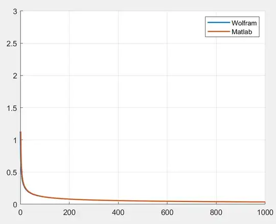

Dividing the result that I obtained from Matlab by $\sqrt{2\pi}$ and when I accordingly define H2 = (2*sqrt(-i).*(sign(w-1)+1)).*(1/2-i/2)./(sqrt(2*pi).*sqrt(abs(w-1))), then both charts are graphically identical:
    Have you checked the documentation to see which conventions for the Fourier transform that the programs use? – Hans Lundmark Sep 01 '21 at 07:37
  • Thank you for that hint. Truely spoken - I didn't check that, but will definitey take a look at this. Nevertheless I am wondering why such a discrepancy (in the chart) can emerge. –  Sep 01 '21 at 07:39
    What's strange about that? They just seem to differ by a factor of $\sqrt{2\pi} \approx 2.5$, probably due to different conventions. – Hans Lundmark Sep 01 '21 at 07:59
  • Ok thank you for this clarification - I am a bit new to the area of Fourier Transforms. And if you say that these deviations are normal/usual, then this is a very valuable finding for me too. –  Sep 01 '21 at 08:05

  • @StevenClark: Your comment is intersting - I added another chart (into the question area) where I divided the second fucntion H2 by $\sqrt{2\pi}$. Both charts seems to be aligned now. –  Sep 02 '21 at 16:50
  • @EldarSultanow The new formula for $h2$ is not identical which can be seen as a slight difference in the new chart but which is more obvious if you plot the two formulas or the difference between the two formulas over a smaller range (e.g. $0<w<20$). I believe there's actually an error in the result of one of the two Fourier transforms. – Steven Clark Sep 02 '21 at 17:08
  • ok now it becomes interesting - I doublechecked the latex and still do not see the flaw. But I am now recognizing the slight difference of both charts. –  Sep 02 '21 at 18:14
