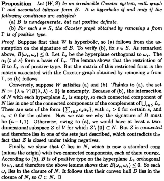

Let $(W,S)$ be an irreducible Coxeter system with non-degenerate bilinear form $B$ on the Euclidean vector space $V$. The simple root attached to $s\in S$ is denoted by $\alpha_s\in V$. Let $\{\omega_s:s\in S\}$ be the dual basis of $\{\alpha_s:s\in S\}$. In Section 6.8 of Humphreys' book “Reflection groups and Coxeter groups” he defines $C=\{v\in V:\forall s\in S:B(v,\alpha_s)>0\}$ and $D=\overline{C}$ (closure with respect to the Euclidean metric). He claims that $D$ is the convex hull of the vectors $\omega_s$. I can't believe this, since for instance, $2\omega_s$ belongs to $C\subseteq D$. Perhaps he meant conical hull?
What bothers me more is the proof of Proposition 6.8. In the last paragraph, I understand that $N$ has two connected components and both are convex. Each $\omega_s$ is contained in one of the components. Now he wants to argue with convexity, but why lie all $\omega_s$ in the same component? Here is the excerpt: enter image description here

    Sorry I don't have a complete answer for you, I spent some time thinking about it but couldn't close out the argument in Proposition 6.8. What I can say is that when Humphreys says "convex hull", he means "the cone over the convex hull", or more precisely the $\mathbb{R}^{\ge0}$ span of the simplex spanned by those vectors. For the second part of your question, you might like to compare to Exercise 13 in Chapter V of Lie Groups and Lie Algebras, by Bourbaki, where they walk you through the proof of this Proposition. – David Sheard Aug 22 '21 at 17:57

Please check page 25 of these notes: https://mathweb.ucsd.edu/~ssam/old/21S-264C/notes-264C.pdf
Below is another proof I figured out myself, it's a bit more tedious than the note given above, but it proved a stronger result: For hyperbolic groups, the closure of the Tits cone is equal to exactly one connected component of $H=\{v\in V\mid (v,v)\leq 0\}$, say $H^+$, and has 0 as the only intersection with the other component $H^-$.
A reference is Howlett's paper: https://link.springer.com/article/10.1007/BF02677488. I will directly cite the results proved in this paper. I'll also keep the notations consistent with Howlett.

  • Now I have read the proof in the notes you have linked. There is one part, which I do not understand: "If $v\in N$, then either $v^+ \in N$ or $v^-\in N$, and in either case, its negative is also in $N$. We conclude that the two connected components of $N$ correspond to when all the coefficients (in the $\alpha$ basis) are all positive or all negative." Can you elaborate on this? – Brauer Suzuki Dec 16 '23 at 19:40
  • This is because any vector $(v,v)<0$ when expressed as a linear combination of the simple roots $v=\sum c_s\alpha_s$, all the coefficients $c_s$ are nonzero and have the same sign. – zemora Dec 17 '23 at 01:30
I tend to avoid all geometric interpretations. Let $M=(\alpha_s,\alpha_t)_{s,t}$ be the Gram matrix of the Coxeter system. We know that $M$ has signature $(n-1,1)$. The dual basis can be expressed as $\omega_s=M^{-1}e_s$ where $e_s$ is the $s$-th standard basis vector. Using that $\det(M)<0$ and every principal minor $\det(M_{ss})>0$, we see that $(\omega_s,\omega_s)=e_sM^{-1}e_s=\det(M_{ss})/\det(M)<0$ (this is basically the lemma before the proposition). We need to show that $vM^{-1}v<0$ for every non-negative integer vector $v\ne 0$. Why is that?
