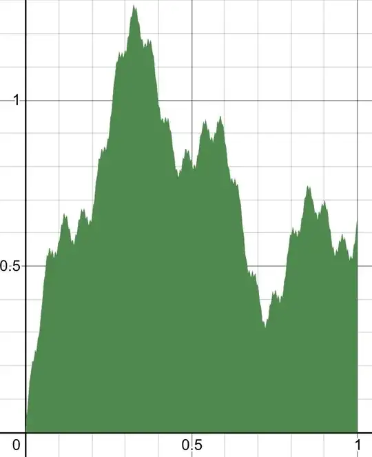

Finally, here is an interactive graph of the Darboux function and a beautiful visual representation of the constant: enter image description here
