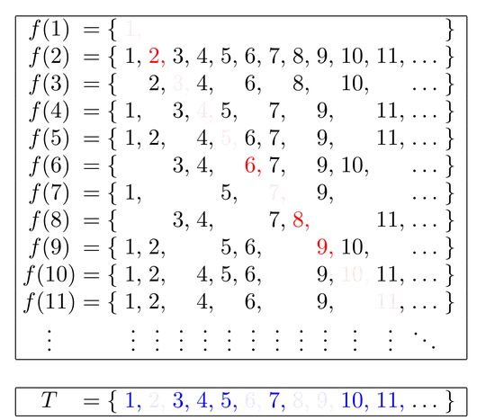

For example, illustration of the generalized diagonal argument: The set $T = \{n∈ℕ: n∉f(n)\}$ at the bottom cannot occur anywhere in the range of $f:ℕ→P(ℕ)$. The example mapping $f$ happens to correspond to the example enumeration $s$ in the above picture.
