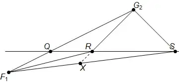

In the style of classical geometry:
Let $\ell$ be the line, $F_1, F_2$ be the two foci, and $G_2$ be the reflection of $F_2$ through $\ell$. Then for any point $P$ on the line, $PF_2 = PG_2$, so the intersection of $\ell$ with the ellipse consists of all points $P$ where $F_1P + PG_2 = k$.
Let $Q$ be intersection of $F_1 G_2$ with $\ell$: $F_1 P + PG_2$ is minimized when $P=Q$, by the triangle inequality. Suppose that $Q, R, S$ appear on line $\ell$ in that order. Then $R$ is in the interior of $\triangle F_1 G_2 S$, so ray $G_2R$ must intersect $F_1S$ at some point $X$:
By a series of triangle inequalities, $F_1S + SG_2 > F_1 R + R G_2$, because
\begin{align} F_1S + SG_2 &= F_1X + XS + SG_2 \\ &> F_1X + XG_2 \\ &= F_1X + XR + RG_2 \\ &> F_1R + RG_2. \end{align} In particular, we cannot have $F_1S + SG_2 = k$ and $F_1R + RG_2 = k$ at the same time. Therefore points of intersection between the line and the ellipse cannot be on the same side of $Q$ - so there can be at most two of them.
I suppose I assumed that the line $\ell$ does not pass between $F_1$ and $F_2$: if it does, then we do the same thing, except without the reflection step first.
