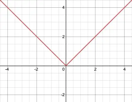

The function $f(x)=|x|$ is probably the simplest example of how a function can be continuous, and yet not differentiable, at a point:
Graph of |x|
It is clear just by looking at the graph that $f$ is continuous at $0$, but $f'(0)$ does not exist as $f'_+(0)=1$ and $f'_-(0)=-1$. However, what I find unsatisfying about this example is that $f$ is still fairly well-behaved around $0$—it is meaningful to ask about the 'rate of change' of the function, it's just that we get different answers when we zone in from the left-hand side compared to the right-hand side. I'm looking for a function where it is not meaningful to talk about the 'rate of change' at all, and yet the function is still continuous at the point in the question.

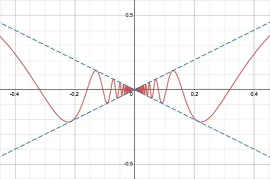

    @Buraian: A function is semi-differentiable at a point if the left-hand derivative exists or the right-hand derivative exists. So $|x|$ is semi-differentiable at $0$, for example; $x^2$ is also semi-differentiable at $0$ (because it is differentiable at $0$). However, the function$$ f(x)=\begin{cases} x\sin(1/x) &\text{if $x\neq0$} \ 0 &\text{if $x=0$} \end{cases} $$ is not semi-differentiable at $0$. – Joe Jun 14 '21 at 16:45

Consider the function $x\sin(1/x)$, continuously extended at $0$. The left and right derivatives at $0$ don't exist as $\sin(1/h)$ keeps oscillating between $-1$ and $1$ as $h\to 0$:
Graph of xsin(1/x)

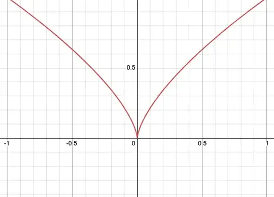

Another fairly standard example is $f(x) = x^{2/3}$, which (like the absolute value function) has a cusp at $x = 0$, but which (unlike the absolute value function) has neither a left-handed nor a right-handed derivative, because the graph of $y=f'(x)$ has a vertical asymptote at $x = 0$. enter image description here

  • My favourite version of this is $|x|^{s-1}x$ whose graph is a differentiable curve but the graph coordinates break down in the manner you described – Calvin Khor Jun 15 '21 at 00:41
