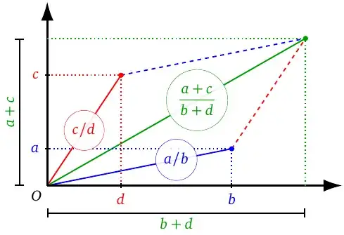

Remark $ $ Note that the mediant $\,\frac{a}b\oplus \frac{c}d = \frac{a+c}{b+d}\,$ can be viewed geometrically as the slope of the diagonal of a parallelogram with sides of slope $a/b$ and $c/d$ formed by the vectors $(b,a)$ and $(d,c),\,$ which makes its "intermediate" property intuitively clear geometrically, i.e. the diagonal lies between the sides, as illustrated below.
$\quad$ enter image description here
This simple mediant property is used in many places, e.g. the classical proof of irrationality of $\sqrt 2$. It is a simple example of various geometric (lattice theoretic) methods that often lead to beautiful geometric proofs of number theoretical results (e.g. a key property of Farey sequences can be proved using Pick's area theorem as here).
