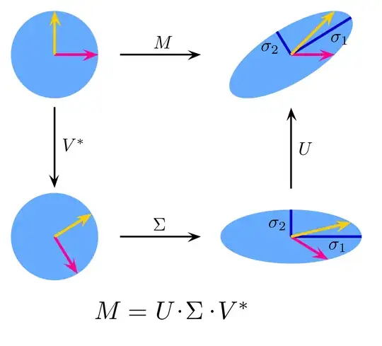

Think of a matrix $A$ as a transformation of space. SVD is a way to decompose this transformation into a series of three consecutive, canonical transformations: a first rotation, scaling and a second rotation. There is a nice picture on Wikipedia showing this transformation: Representation of SVD

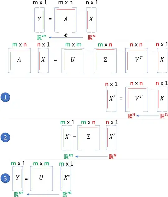

enter image description here The inserted image hopefully adds to the answer of TheSHETTY-Paradise.
It shows the three operations:
(1) a rotation in the 'domain' space,
(2) a scaling and a change of dimension and then
(3) a rotation in the image space

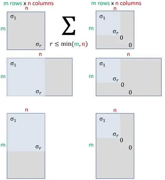

The other image shows all the possible shapes of $\Sigma$

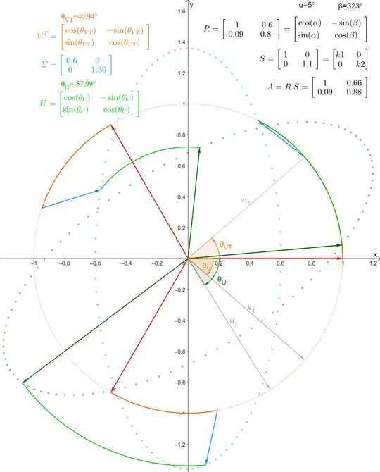

I visualized SVD for myself using the following plot:enter image description here
There is a Geogebra app under the link below,
you can play around changing the matrix and seeing the effect on the SVD: singular value decomposition visualized
