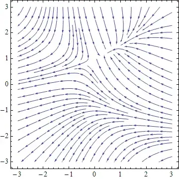

You should look at these built in plots:
StreamPlot and ListStreamPlot
StreamPlot[{-1 - x^2 + y, 1 + x - y^2}, {x, -3, 3}, {y, -3, 3}]
StreamDensityPlot and ListStreamDensityPlot
VectorPlot and ListVectorPlot
VectorPlot3D and ListVectorPlot3D
