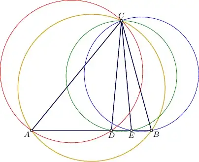

Consider this construction:
$\triangle ABC$, $D,E\in AB$, $|CD|=u,\ |DE|=v,\ |CE|=w$, $\angle CDE=\angle CDB=\delta$. Let $R,R_1,R_2,R_3,R_4$ be the radii of circumscribed circles around $\triangle ABC,\ \triangle CAD,\ \triangle CDE,\ \triangle CEB$ and $\triangle CDB$, respectively. Then we have an identity
\begin{align} R_1\cdot R_3&= R\cdot R_2 \tag{2}\label{2} . \end{align}
Now, let's move the point $E$ toward $D$ until they coincide. Then $R$ and $R_1$ stay the same, $R_3$ becomes $R_4$. And what will happened to $R_2$? From this point of view, $R_2=\tfrac u2$ would be a wrong choice. More appropriate would be to consider this degenerate triangle $CDD$ as one with the fixed side length $u$ and fixed angle $\delta$:
\begin{align} S_{CDE}&=\tfrac12uv\sin\delta ,\\ R_{CDE}=R_2&= \frac{uvw}{4\cdot \tfrac12uv\sin\delta} =\frac{w}{2\sin\delta} \tag{3}\label{3} , \end{align}
so when $w\to u$, to get sensible result in \eqref{2}, we must have
\begin{align} R_{CDD}&= \frac{|CD|}{2\sin\delta} \tag{4}\label{4} , \end{align}
and \eqref{2} transforms into
\begin{align} R_1\cdot R_4&= R\cdot \frac{|CD|}{2\sin\delta} \tag{5}\label{5} . \end{align}
So, the definition for the circumradius of the degenerate triangles is indeed context-sensitive.
