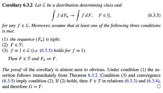

However, I am having trouble proving the following corollary (I copied and paste straight from the text): enter image description here
I am having trouble showing that (2) is sufficient. The argument they gave appears to be down the lines of the following (just basing off the proof of the previous theorem)
Consider the sequence $F_n$, by Helly's selection theorem, we have $F_{n_k}$ converges weakly to some $G\in \mathcal{G}$. Further, we have, for each of those subsequences that converge weakly, $$\lim_{k\to\infty}\int f\ \mathrm{d}F_{n_k} = \int f\ \mathrm{d}F.$$ Now, it would be nice if we also write (I think the author just assumes this, but this does not appear to be true for me) $$\lim_{k\to\infty}\int f\ \mathrm{d}F_{n_k} = \int f\ \mathrm{d}G$$ If that's true, then we're done because that would imply $G=F$ and every subsequence that converges in $F_n$ converges to the same distribution function. But we cannot do that, because $G\in \mathcal{G}$ and we know that weak convergence (as defined by pointwise convergence to all points of continuity in the limit function) is no longer equivalent to convergence in integrals.
TLDR: I have having trouble proving (2) is sufficient in the above corollary and the hint the author gave is confusing.

  • I looked up Helly's selection theorem on wikipedia and it states that the functions need to be uniformly bounded. Are we assuming elements of $\mathcal{G}$ are uniformly bounded by some constants $a$ and $b$, or is there some stronger version of Helly's Theorem? – forgottenarrow Apr 02 '21 at 20:03
  • Ok, I looked up the book. They are assuming that for any $G \in\mathcal{G}$, $0\leq G\leq 1$, so that gives us the uniform bound. – forgottenarrow Apr 02 '21 at 20:07
  • @varpi: For a family $\mathcal{G}$ of uniformly bounded generalized distributions, every subsequence has a subsequence that converges vaguely (i.e. the test functions are continuous functions with bounded support) this is basically Alaoglu's theorem. If in addition, $\mathcal{G}$ is tight, then to convergence is weakly (test functions are bounded continuous functions). – Mittens Apr 04 '21 at 18:17

Edit: The initial argument I suggested was incorrect. I am not deleting the answer because it has accumulated some relevant comments. See the answer by Chris Janjigian that gives a counterexample to Cor 6.3.2 parts (2) and (3).

  • I don't think it is true that if $F_{n_k}$ converges weakly to a generalized distribution $G$, you have the convergence of integrals (a fact that OP stated in their question). (One can think of $F_n$ being delta masses at $n$, which weakly converge to the generalized distribution that puts 0 mass on all reals, but $\int 1 dF_n \not \rightarrow \int 1 dG$) – E-A Apr 03 '21 at 07:33
  • E-A: You are right. – Yuval Peres Apr 03 '21 at 17:39

    @varpi can you explain your specific situation further as your answer if you get the chance? will definitely upvote it (and appreciate it) as I spent quite a bit thinking about this and even a special, relevant case could be interesting. I do believe theorem as stated is false (if only for the simple reason that Durrett or Chung would have included it); I think some additional property should be imposed on L precisely to allow these limits. – E-A Apr 04 '21 at 05:00
    @E-A sure, but I am not so sure as to whether you'll find it super enlightening as it's basically just a part of Levy's continuity theorem. – varpi Apr 04 '21 at 05:10
    @E-A added a brief outline of my special case and solution – varpi Apr 04 '21 at 05:17
    @varpi much appreciated; you were right; I am not super enlightened since I went over that case trying to answer your question. I believe the theorem as stated is false, but I could not come up with a class L that violates it. – E-A Apr 04 '21 at 05:23
  • @YuvalPeres: If the family $\mathcal{G}$ of generalized distributions is uniformly bounded, then Avery sequence in $\mathcal{G}$ was a vaguely convergent subsequence (test functions are continuous functions with compact support). This is related to Alaoglu's theorem. If in addition the family is tight, then convergence is weakly (test functions are bounded and continuous). – Mittens Apr 04 '21 at 18:21
  • @OliverDiaz: All is well if you assume tightness (condition (1) in the Cor.). The difficulty occurs if you just assume condition (2) and $\mathcal L$ is an arbitrary distribution-determining class. – Yuval Peres Apr 04 '21 at 18:24
  • @OliverDiaz: See the counterexample in the answer by Chris Janjigian. – Yuval Peres Apr 05 '21 at 16:35
  • @YuvalPeres: What I said was that if $\mathcal{G}$ is uniformly bounded i.e. $\sup_{G\in\mathcal{G}}(|G(\infty)-G(-\infty)|)<\infty$ (all G monotone nondecreasing) then, Alaoglu's theorem along with separability, implies that any sequence in $\mathcal{G}$ have a subsequence converging vaguely i.e., in the weak-topology $\sigma(\mathcal{M}(\mathbb{R}),\mathcal{C}_{\infty}(\mathbb{R}))$. If in addition*, $\mathcal{G}$ is tight, then convergence is in fact weak ( as in Prokhorov) as you know. I agree, for different determining spaces weak convergence fails as counterexample shows. – Mittens Apr 05 '21 at 16:54
