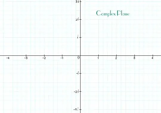

complex plane from a tutorial

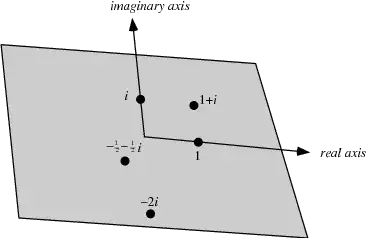

We think about $\sqrt{-1}$ as part of a larger entity called the complex plane (google is your friend). $\sqrt{-1}$ is 90 degrees around the complex plane, whereas $-1$ is 180 degrees around the complex plane -- a fully turned-around $+1$. The 180-degree turn is the number line you learned in school; going only 90 degrees enters the complex plane.
The unifying idea is that a pair of imaginary and "real" numbers $x + i \cdot y$ are equivalent to a radius and an angle. Simple enough if you're familiar with rectangular and polar coordinates. But the key observation by de Moivre which unlocked a deep and mysterious world is that this can all be done with the natural base $e$.
  • $\exp (i \cdot x) = \cos x + i \sin x$.
Therefore $x+\sqrt{-1} \cdot y = \sqrt{x^2 + y^2} \cdot \exp (\sqrt{-1} \cdot \arctan {y \over x})$, which we think of as
  • $\mathrm{radius} \cdot e^{i \cdot \mathrm{angle}}$.
