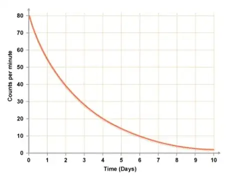

I am clearly not a math genius but in my mind I am trying to get curves that resembles this (in general shape, ignore the axis values):
Exponential Decay:
Exponential Decay

  • From the graph I would say that the differential equation is $y^{'}(x)=\frac{a}x$. This is the continuous change, which matches the graph. And the solution is $y(x)=a\cdot \ln(x)+C$, where $a$ and $C$ (integration constant) are parameters which can be specified. – callculus42 Mar 10 '21 at 19:23
  • @callculus the graph is just a visual aid, not intended to be solved, the basic function I believe is what you have stated although I do not know how to employ that given the parameters I have specified (e.g. what is A and C in my case?) – WerkkreW Mar 10 '21 at 19:47
  • Can you give me your conditions in terms of $y(x_0)=y_0$?. For instance, $y(1)=6$ – callculus42 Mar 10 '21 at 19:56
    $y(0) = 0.10$ and $y(720) = 0$ in the example parameters I provided – WerkkreW Mar 10 '21 at 20:18
  • OK. The problem is, that the domain of $x$ at $y(x)$ is greater than $0$, $x>0$. So it is not possible. – callculus42 Mar 10 '21 at 20:46
  • To get a solution we can define $y(x)= -\ln(x+b)+C$ with the differential equation $y^{'}=-\frac1{x+b}$. So $y(0)=-\ln(b)+C=0.1$. And $y(720)=-\ln(720+b)+C=0$. The solution is $y(x)=-\ln(x+6846)+8.93142$ – callculus42 Mar 10 '21 at 21:24
