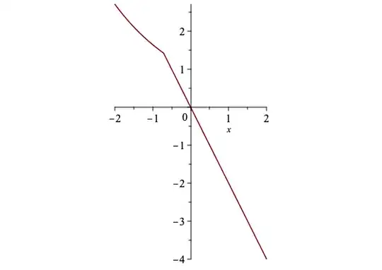

remark
It is not enough to assume (for example) that $f(f(x)) = e^x$ for all $x>1$. You must assume (as the OP says) $f(f(x))=e^x$ for all $x$. This is used in Edit 2.
The following function $f : \mathbb R \to \mathbb R$ is continuous and $f(f(x)) = e^x$ for all $x > 1$ but fails the required conclusion.
graph
$$ f(x) = \begin{cases} -2x,\quad &x\ge T \\ e^{-x/2},\quad &x < T \end{cases} $$ Here $T \approx -0.7148$ is one of the points where the two graphs $-2x,e^{-x/2}$ cross.
GEdgar
  • 117,296
  • But according to your function $f$, we have: $f(0)=0$ hence $f(f(0)) = f(0) = 0 \neq 1 = e^0 $ ! – NN2 Mar 06 '21 at 19:46
    @WillJagy This answer doesn't solve the question or provide anything that we can use to solve the question. So what is its purpose here? – NN2 Mar 06 '21 at 20:05
