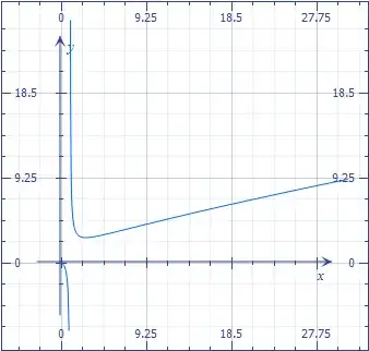

Not sure they saw $\log$ yet, but to "visualize" and get the numbers out of the exponentiation, reduce the scale using the $\log$
$$\log(2^x) = x \cdot \log(2)$$ $$\log(x^2) = 2 \cdot \log(x)$$
Removing the constants, we compare now $x$ and $\log(x)$, and $$\dfrac{x}{\log(x)}$$grows quickly.

We can show a more general result: a (growing) exponential grows faster than any power. Eventually,
$$a^x>x^b.$$
Indeed, taking the logarithm, this is equivalent to
$$x\log a>b\log x$$
or
$$\frac x{\log x}>\frac b{\log a}.$$
The LHS is an unbounded function and the RHS a constant. (For $x>e$,
$$\frac{ex}{\log ex}=e\frac{x}{\log x+1}=e\frac{\log x}{\log x+1}\frac{x}{\log x}\ge\frac e2\frac{x}{\log x}.)$$
