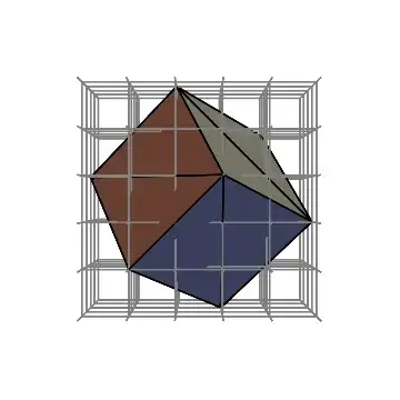

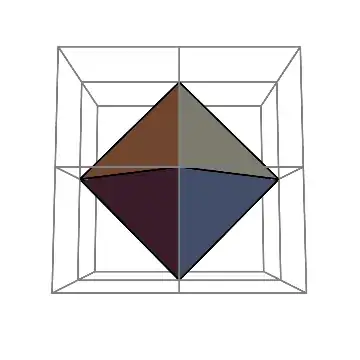

It's quite easy to find a regular square prism (cube) or a regular triangular antiprism (octahedron) with vertices in $\mathbb Z^3$. Take for instance, take the convex hulls $$ \begin{align*} &\operatorname{hull}(\{(0,0,0),(0,0,1),(0,1,0),(0,1,1),(1,0,0),(1,0,1),(1,1,0),(1,1,1)\}), \text{ and} \\ &\operatorname{hull}(\{(0,0,1),(0,1,0),(1,0,0),(0,0,-1),(0,-1,0),(-1,0,0)\}) \end{align*} $$ respectively.
For a much more interesting example of embedding the cube, see Table 1 from Ionascu and Obando: $$ \operatorname{hull}(\{(0, 3, 2), (1, 1, 4), (2, 2, 0), (2, 5, 3), (3, 0, 2), (3, 3, 5), (4,4, 1), (5, 2, 3)\}). $$

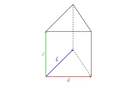

Suppose that there exists a triangular prism in $\mathbb{Z}^3$ of side length $s$. From a given vertex $V$, let $a$ and $b$ be the vectors on the triangular face containing $V$ and $c$ the vector from $V$ to its pair on the other triangular face. Note that $a,b$, and $c$ are all of length $s$.
Now, consider the integer vector $a\times b$; since $a$ and $b$ are $60^\circ$ apart, it has length $s^2\cdot\frac{\sqrt{3}}2$. Up to a change of sign, this vector is parallel to $c$, so $c$ is a rational multiple of $a\times b$ (since both lie in $\mathbb{Z}^3$). Thus, $s$ and $\frac{s^2\sqrt{3}}2$ differ by a rational factor, so we conclude that $s$ is a rational multiple of $\sqrt{3}$.
This means that we can scale the prism so that its side length is an integer multiple of $\sqrt{3}$. Then scale it by a further factor of $2$, so that the midpoints of each edge also have integer coordinates. Let $k\sqrt{3}$ be the integer distance from a vertex to a midpoint of an edge.
But now consider the integer vector from the midpoint of a non-triangle edge to a non-adjacent vertex: it has length $(k\sqrt{3})\cdot \sqrt{5}$.
So, the squared distance $15k^2$ between these two integer points is the sum of three squares. Note that $k^2$ is of the form $4^n(8a+1)$, so $15k^2$ is of the form $4^n(8b+7)$. But, by Legendre's three-square theorem, such integers are not expressible as the sum of three squares! So no such prism exists.
