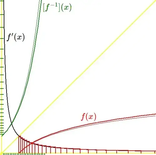

Below is a visualization of the technique employed, for the special example $f'(x)=[f'(x)]^{-1}=1/x$ , $\color{red}{f(x)=\ln(x)}$ , $\color{green}{f^{-1}(x)=[f^{-1}]'(x)=e^x}$ .
Further specifications: $-0.1 \le x \le 9$ ; $-0.1 \le y \le 9$ ; $dA = 1/10$ ;
thick colored lines numerically, thin colored lines analytically.
