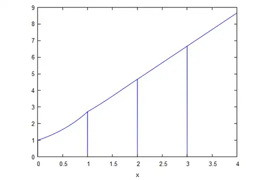

You seem on the right track.
Letting $g(x) = E[n(x)]$, applying the total law of expectation and using the fact that $f_U(u)=1 [0\le u \le 1]$ I get:
$$ g(x) =\begin{cases} 1 + \int_0^x g(u) du &0\le x\le1\\ 1 + \int_{x-1}^x g(u) du & x >1 \\ \end{cases} $$
This gives $g(x) = \exp(x)$ for $0\le x\le1$
In general, $g(x)$ can be expressed as a sum of piecewise differentiable functions in each interval $[k,k+1]$, $g(x) = \sum_{k=0}^\infty g_k(x) $ where
$$g_k(x)= \exp(x-k) h_k(x-n) \quad [ k\le x < k+1] $$ and $h_k(\cdot)$ is a polynomial of degree $k$
The first values are $h_0(x)=1$, $h_1(x)=e-x$ , $h_2(x)=\frac{{{x}^{2}}}{2}-e x+{{e}^{2}}- e$
For large $x$, $g(x) \approx 2x + \frac23$ (empirically)
Added: The functions $h_k(x)$ are produced by this recursion:
$$ h_k(x) = e \,h_{k-1}(1) - \int_0^x h_{k-1}(u) du $$
- 66,202
