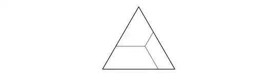

I believe there is exactly one way (up to combinatorial equivalence) to arrange 3 trapezoids with angles of $60^\circ$ and $120^\circ$ into an equilateral triangle:

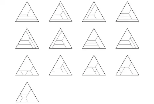

With $5$ trapezoids, there are many more; I count at least $13$ (thanks to Dan Uznanski for discovering the last of these):
In general, how many ways are there to do this with $k$ trapezoids, and what are the corresponding arrangements?
Knowing that the sequence starts $1,2,13?,\ldots$ isn't quite enough to try and find it on OEIS. (I'd also appreciate hearing about any configurations that I may have missed above.)

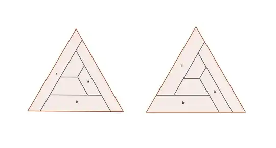

I. As OP’s comment points out, the above answer rests on a false premise, that every distinct $k+1$ tiling of the equilateral triangle arises either from the addition of one trapezoid along an entire side of a k-tiled triangle, or from the division of one of the trapezoidal tiles within the triangle by a line parallel to the trapezoid's base, as in the generation below of six $k=6$ tilings from the first of OP's thirteen $k=5$ tilings by adding a trapezoid along bottom, right, and left in the first row, and by bisecting in turn the three inner trapezoids in the second row. I followed this same order in producing and numbering all the arrangements initially found. six k=6 from one k=5
But although this method finds (when duplicates are set aside) a portion of the distinct $k+1$ tilings of the triangle, it does not find all of them. As the comment notes, the following tiling for $k=6$, for example, does not arise in this way from any of the distinct tilings for $k=5$. OP counterexample Indeed, even from OP's last five tilings for $k=5$, it appears there are at least two other ways to generate a $(k+1)$-tiling: transformation and trisection.

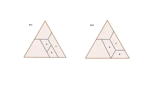

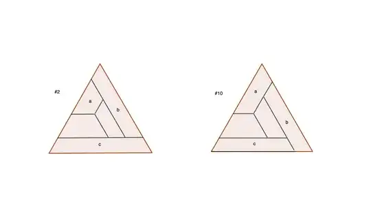

II. OP's #$2$ for $k=5$ arises by addition of one tile to $4a$, as in my method, but #$10$ does not arise from $k=4$ but rather by a transformation of #$2$ for $k=5$, #2-#10 in which trapezoid $a$ expands into $b$ and $b$ in turn expands into $c$. Similarly, OP's #$13$ rotated is a modification of #$11$, transformation #11-#13 by expansion of $a$ into $b$ and $b$ into $c$.

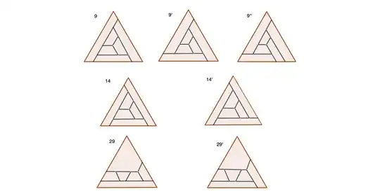

The figure above missing from my count for $k=6$ arises by a like transformation of arrangement #$9$ of the sixty-eight I initially found.#9 to OP counterexample where again trapezoid $a$ has displaced some of $b$, and $b$ some of $c$, in the figure on the right compared with #$9$ on the left.

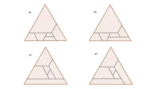

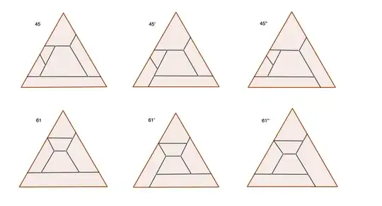

But such transformations commonly involve only two trapezoids, not three, and a single arrangement can yield more than one. Of distinct arrangements found by my method for $k=6$, seven of them yield one or two arrangements I missed. Figures on the left below are numbered by their place in the sixty-eight distinct arrangements I found for $k=6$ by addition/division from the (slightly re-ordered) thirteen figures for $k=5$, followed on the right by the primed figures my method missed. transformations #9, #14, #29 transformations #34, #37 transformation #45, #61
Each of these transformations is a one-step process in which one trapezoid invades and incorporates part of an adjacent one, e.g. as in #$45$-#$45'$, or #$45$-#$45''$
Just as the last five of the (presumably) thirteen arrangements for $k=5$ were not discoverable by my method from the two arrangements for $k=4$, so for $k=6$ the ten (primed) arrangements above were missed by my method.

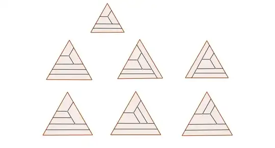

III. And the count is still not complete. OP's $9th$, $11th$, and $12th$ arrangements for $k=5$ arise by trisection of one of the trapezoids for $k=3$. Accordingly, if we trisect in turn each trapezoid of $4a$ and $4b$ in each of the three ways seen in OP's $9th$, $11th$, and $12th$ for $k=5$, the following six (of twenty-four possible) arrangements are new, and we now have $68+10+6=84$ distinct tilings for $k=6$. six by trisection

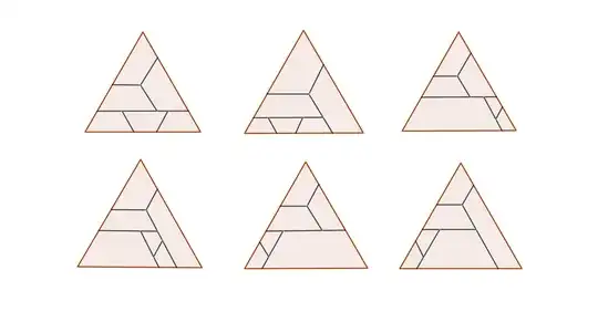

IV. Similarly, exploring the possible arrangements for $k=7$, besides the $283$ found by addition/division applied to the arrangements for $k=6$, new arrangements appear both by the method of transformation as well as by the addition (by trisection) of two trapezoids to each distinct arrangement for $k=5$. Since each trapezoid in an arrangement for $k=5$ can be trisected in three different ways, this raises the possibility of$$5\cdot13\cdot3=195$$new arrangements, although this is reduced to $125$ when $70$ duplicates are set aside. Adding as well the nineteen new arrangements found to result from transformations gives$$283+19+125=427$$distinct arrangements for $k=7$.

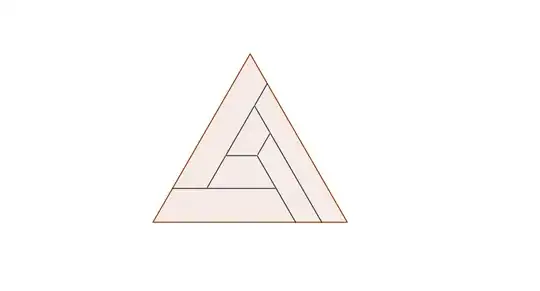

    Here is a $6$-tiling that does not seem to me to be "a $5$-tiling with one tile added" by most definitions. Can you explain why you think all $6$-tilings should arise in such a manner? – RavenclawPrefect Mar 07 '21 at 06:59
    A beautiful tiling, and not among the $68$ found by my method. I should have taken warning from your final five tilings for $k=5$, which do not arise from $4a$ and $4b$ as the first eight do, but rather from the sole tiling for $k=3$—by trisecting one of its trapezoids, as in your $9th$, $11th$, & $12th$, or by sacrificing two of its trapezoids to gain four, as in your $10th$ and $13th$ figures. I already see one I missed for $k=7$: divide one trapezoid from $k=3$ into five. This does not arise by adding one tile to any of the distinct arrangements I found for $k=6$. I need to work on this. – Edward Porcella Mar 07 '21 at 16:53
