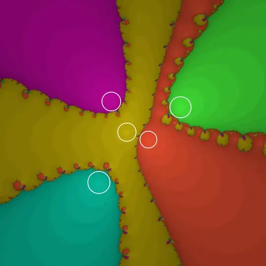

Initial approach: I am using Newton's method for finding roots of polynomial (and sometimes rational) functions in one complex variable: $$z_{n+1} = z_{n} - \frac{f(z_n)}{f'(z_n)}$$ Once I have found each root, I wish to estimate each distance to the nearest (fractal) boundary of the immediate basin of attraction/convergence, like the radii of the white circles shown on the image (background coloured by root, shaded by number of iterations to converge), so that I can check that the atom domain size estimate is smaller:
Newton fractal with immediate basin circles in white
(Image originally from https://commons.wikimedia.org/wiki/File:Newtroot_1_0_m3i_m5m2i_3_1.png modified to add white circles, under CC BY-SA license)
How do I estimate the circle radius given the root? I can evaluate the function and all derivatives as necessary.

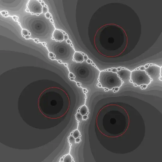

One approach I tried is based loosely on formulas from Wikipedia: for a root $\alpha$, first find the distance $r_0$ from $\alpha$ to the nearest root of $f'(z) = 0$ (this is because of condition 1 from the page; this step may be tricky for the high degree polynomials I will be using in practice...). Then use condition 3c to get $$r_C = \frac{1}{C}\left|\frac{f'(\alpha)}{f''(\alpha)}\right|$$ Then the desired $$r = \frac{1}{2} \min(r_0, r_C)$$ where the $\frac{1}{2}$ is empirically chosen. I also used $C = \frac{1}{2}$ for want of better ideas. Here is the result for one cubic polynomial:
Newton fractal in white with roots circled in red

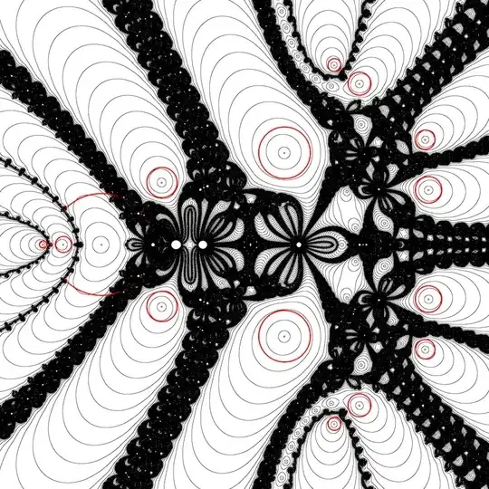

It has the problem of the middle radius of three roots in a row getting very small, and for my actual functions finding the nearest root of the derivative is problematic: using Newton's method gives a root, but not necessarily the nearest, at least I think that is why my code calculates a too-large radius for the 3rd root from the left in this picture:
red circles drawn around roots in a Newton fractal based on period 5 components in the Mandelbrot set

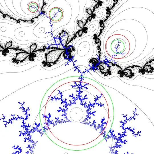

For example some period 6 components in the Mandelbrot set: radius as described above with second derivatives in red, atom domain radius in green, Mandelbrot set boundary in blue, Newton basins in black: Newton basins and the Mandelbrot set The radii computed are not totally ordered (sometimes red is outside green, sometimes the opposite), what I really want to show is that the green circles are inside the immediate Newton basins.

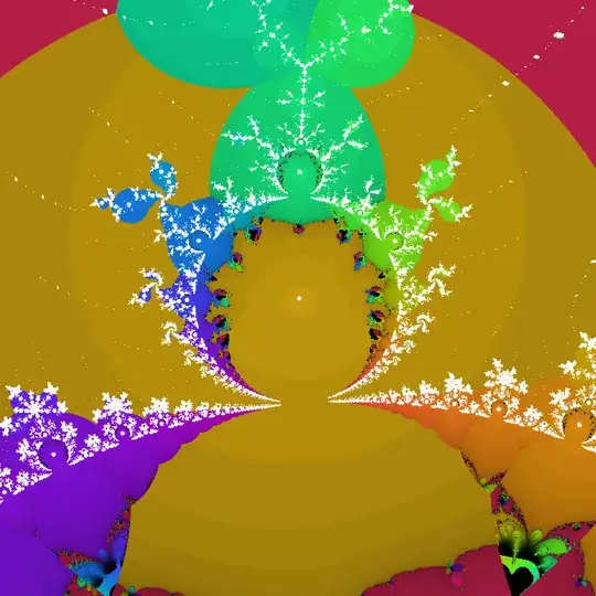

The last image looks quite optimal. Doing directly what you proposed, determine the atom period and apply Newton to try to find the next hyperbolic center for this period gives the Newton-Fractal
X:-1.7578 Y:0.0138 R:5.0e-03

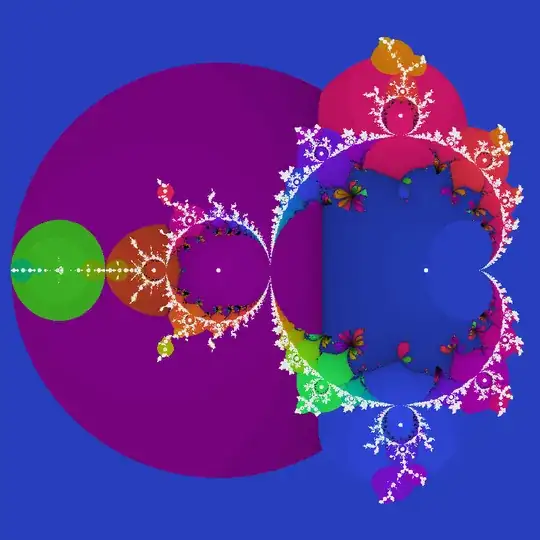

with the full set having the coloration
As usual, color indicates the roots and shading the number of steps needed to reach a neighborhood of the root. The color is white if the root is already reached in the first step, black if no convergence was achieved.
